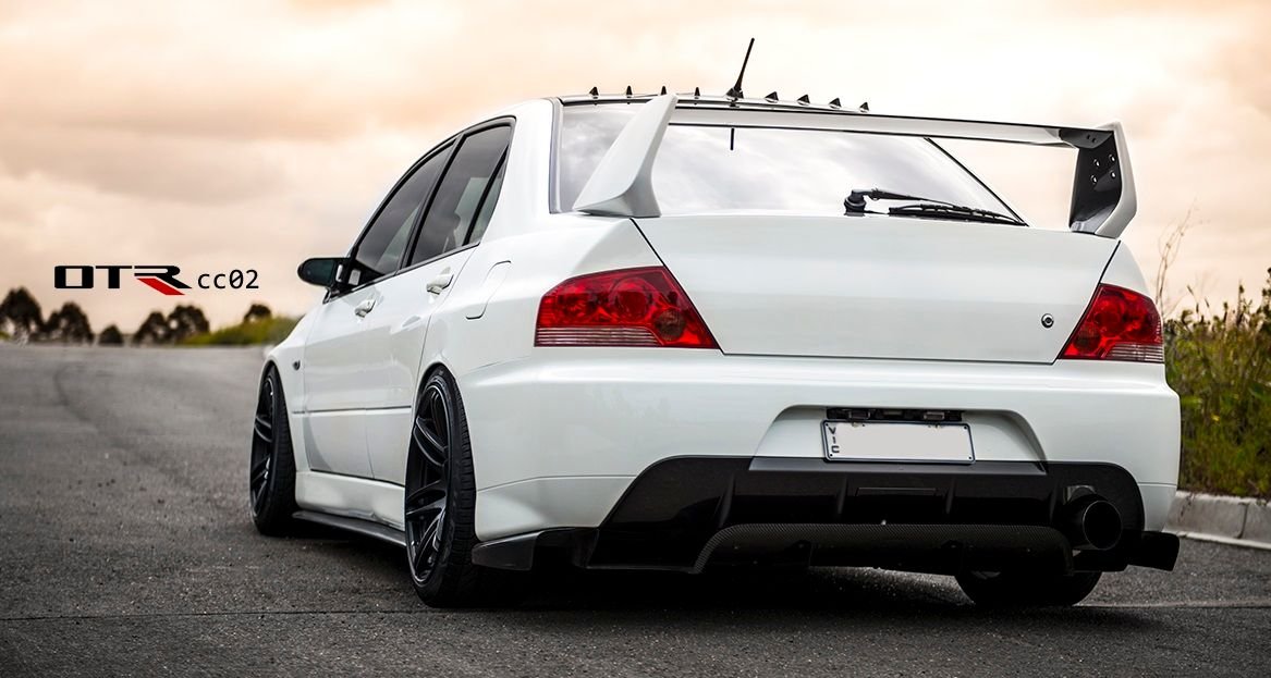

Whats fitted on that EVO looks like +15 & if it was fitted w/a proper tire & some in range camber it would not fit w/out rub
As noted, +35 is really a modest offset that will allow you to run a wide tire & proper camber & will not rub if clearanced correctly
Thats what im going for is the above picture, I will try +15 offset. What tires would you say its running? i figured 235 maybe 245 but I could be wrong entirely.

We are trying to let you know that +15 does not work well. Its way to aggressive. The guys who run it use a tire not specified for that rim width (super stretch. 245 is minimum width allowed on a 9.5") & they run out of spec camber.
The rear fender work required would not be pleasing to the eye
work required to fit +15 wouldnt be? or +35, trying to avoid rolling a whole lot. I dont mind a little but once again just going for tasteful stance.
