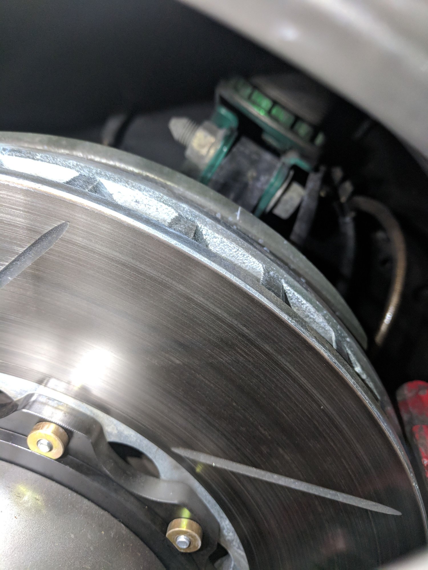

Miles of use on the brake rotors? Could you show us a picture of the surface of the rotors?

Brand new rotors, DBAs was the previous
