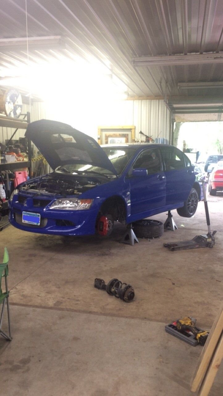

Old Jul 29, 2019 | 09:03 AM
9TechNine9's Avatar
Joined: Mar 2019
Posts: 54
Likes: 14
From: MN
Writing back on my experience after about a week of driving on the SuperPro Front Lower Ball Joints (Kit). It's hard to tell exactly the difference the lower ball joints made compared to OEM because I replaced the front strut assembly at the same time (tie rod ends seemed comparable to OEM) so it will be somewhat comparing apples to oranges. Overall the quality of the parts seem top notch, no hang ups on fitment or missing parts. *Seems obvious, but you WILL need a shop press to install the ball joints. Steering is tight and predictable. Really, I haven't noticed any changes in the geometry of the suspension, maybe it feels a touch lower and there's a bit less body roll, but I can't specifically attribute that to the kit as I did the front shocks at the same time. For somebody in my situation, where I already had the poly bushings on the lower control arm, I would highly recommend going with this kit over buying the whole control arm. This is of course around town spirited driving, no track driving yet. I'll be sure to report back to this thread on durability/reliability of the kit.
