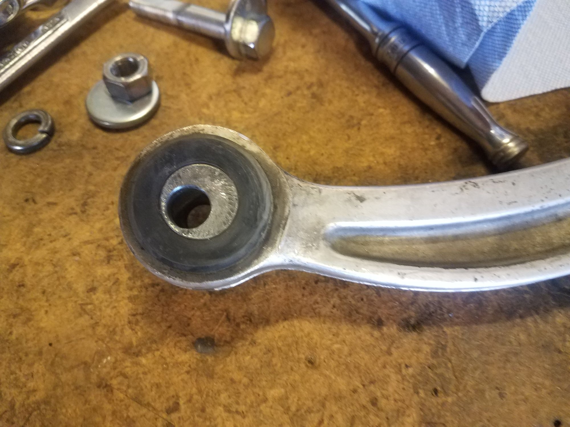

Ebay arms didn't work. The shpericals are too wide, so don't fit the mounting point.
While I had the OEM arms off, I did realize the stock mount is offset, so I flipped out. Should be good to go for toe.
And it turns out my bolts and washers have been getting stripped out because I was at the end of adjustment in the subframe, but the alignment guys were trying to force it.
But I did get measurements on the arms. Will post asap.

I flipped the mount points around and got my alignment right where I needed it. Score!
