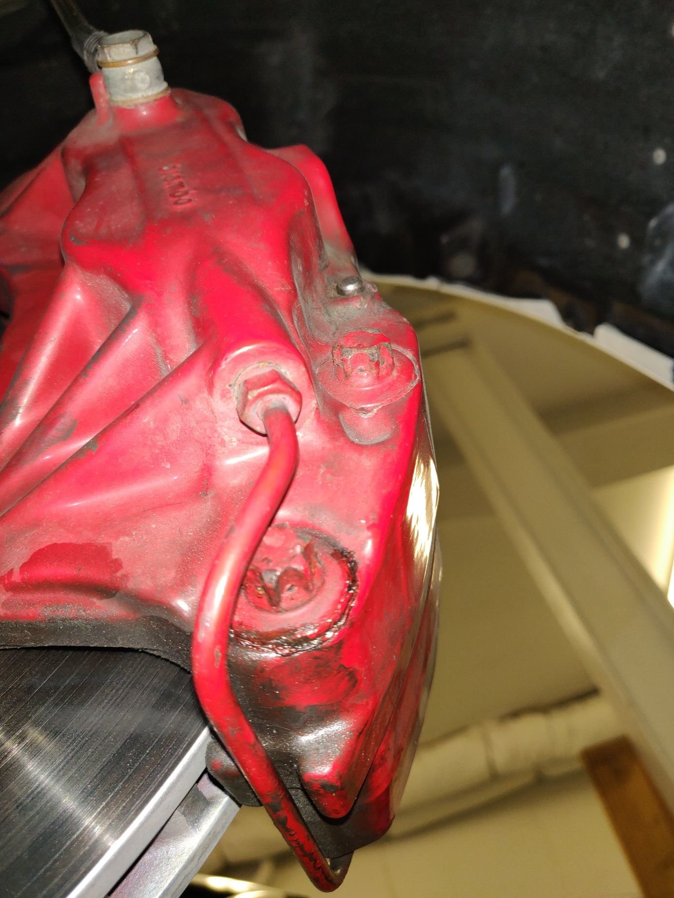

What do I need to tighten to stop this leak? It is surrounded at this screw, but the guy who rebuild/pc'd these calipers say no fluid actually comes out of there. The cross over tube and line in back are dry. What's causing this?

You're sure a piston isn't leaking?

Clean it off and check again.
Was my first thought as well...

got them off, swapping in rebuitl calipers - was a torn boot. what causes that? esp considering i have ss pistons & ti shims
