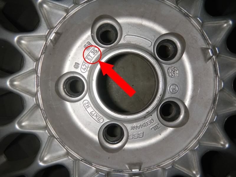

Old Jun 16, 2020 | 05:25 AM
Originally Posted by Eruchavez
I currently have 245/40/18 and they don't rub or anything, I just want to run wider tires. Is there a way to find out the offset on the wheels?
Yeah, pull the wheel & look for this marking. Let us know what it is
Old Jun 16, 2020 | 03:14 PM
Eruchavez's Avatar
Joined: Sep 2018
Posts: 6
From: El Paso, TX

Old Jun 20, 2020 | 06:18 PM
Good job on finding the offset. That is a nice wheel size (18x9 +30)
Sure, the 255/35 or the 40 is most common. You can go larger, up to a 265/35 but more rear fender work will be needed
W/the +30 running a 255/40 expect a rear fender roll & possibly the relocation of the rear bumper bolt. Some rear camber will be needed as well (approx -1.8 degrees to help clear the rear fender)
