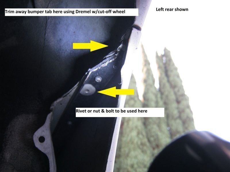

Yeah, to fully clear, a rear fender roll, bumper bolt relocation as well as a slight rear fender pull will be needed to fully clear. (tire size will certainly play a roll in how much of each is needed)
Let me know what exact tire size & i will lay it out on the calculator & give you a better idea
Heres a pic of the bolt relocation technique

Bottom line is this: There have been guys running the +22 w/the 9.5" that only did the rear fender roll & maybe some serious rear camber setting & will comment that it works fine, w/maybe some rub on hard dips or when they carry passengers
My suggestion of doing the rear fender roll, bumper bolt relocation & the rear pull is for full clearance w/zero rub. Thats what i needed as i tracked my EvO for 5 years & rub is a no-go as im sure you understand
Any other questions, let me know. Hope this helps
