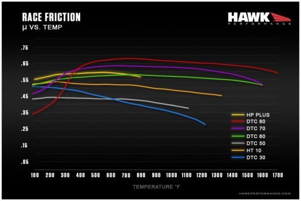

^ Hawk used to offer the "Street/Race" pad. Disco now. Yes, pretty good initial bite from ambient.
They still offer the "HPS 5.0" pad. I have both at the moment. I was doing some HPDEs with the Street Race as a compromise pad since I didn't want to swap pads/rotors as I was less focused on chasing lap times, and more focused on just getting out there with the car while juggling all the other various life stuff.
For what it's worth, the Hawk Street/Race is the same compound as their DTC-30. The difference being that the Street Race have chamfered edges and shims to aid in reducing noise. Aside from that, they are 100% a DTC-30. With the Evo Brembos, they were loud. I also had them on an S2000 with stock sliding calipers, and they were much less noisy.
High metal content...they eat rotors. Very dusty.
They are sensitive to how quickly you bring them up to temp, and are easy to overheat and will leave deposits pretty readily- example, at Fontana it's a lot of big acceleration, linked by corners. You have a big straight with ample time for cooling, and a 280whp, stock weight Evo can get up to ~130. Maintaining 120-125 through the banking (T1&T2). Then all the brakes, down into 2nd, for T3. These pads did not like this track. Maybe they would have been better in a different scenario.
They definitely did better on the lighter S2K at Laguna Seca.
One of their strengths is they have decent bite and torque from ambient. They are targeted at dirt track/circle track.
Hawk has since DC'd the Street/Race variant. I still have my set, but not sure I will ever put them back in.
I have the HPS 5.0s on the car now. Not super impressed. They aren't bad, but the bite from ambient isn't amazing, and while they can handle some heat they leave me wanting something better. Decent modulation though when they are in the sweet spot temp-wise.
