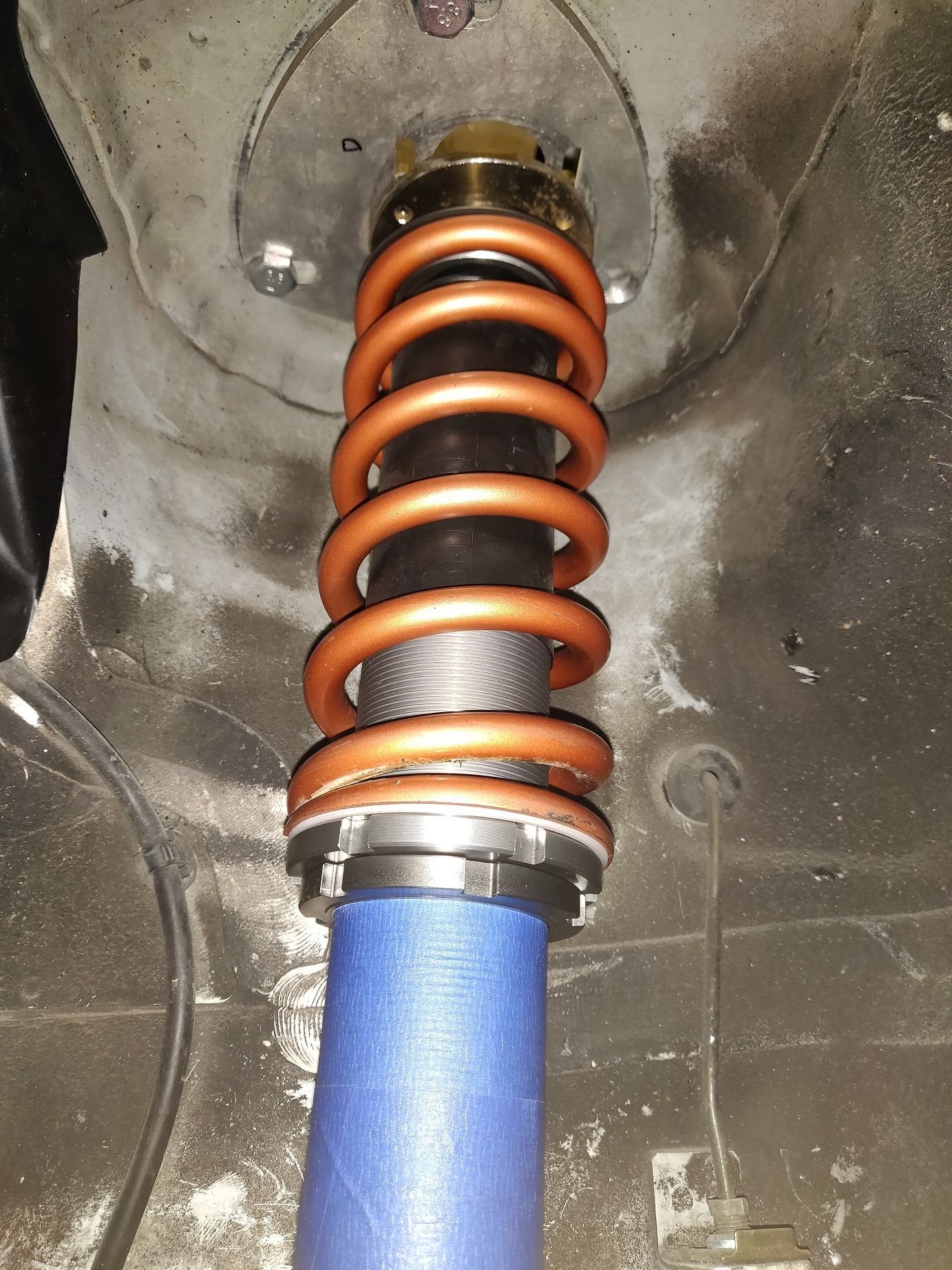

also, for u dd'ers - spray ur locking rings with a little wd40 so they dont seize together, and also wrap your threads with painters tape it's not pretty but it keeps them clean (later i even measured and wrapped the top area above the seat

I have been spraying the threads and locking rings but never thought of the painter's tape. Great idea.

Second that. Wish I thought of the painters tape..for my next set!
