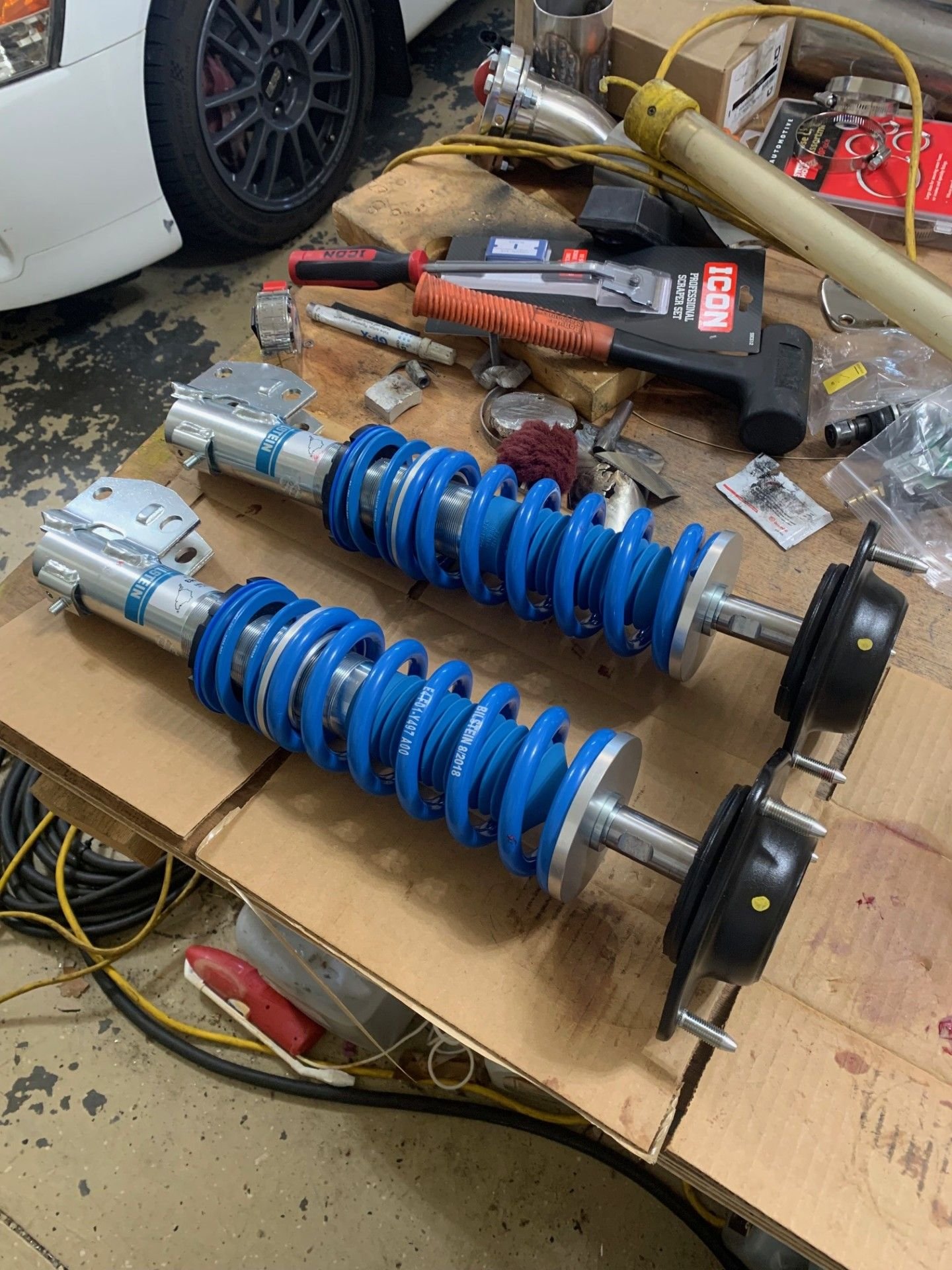

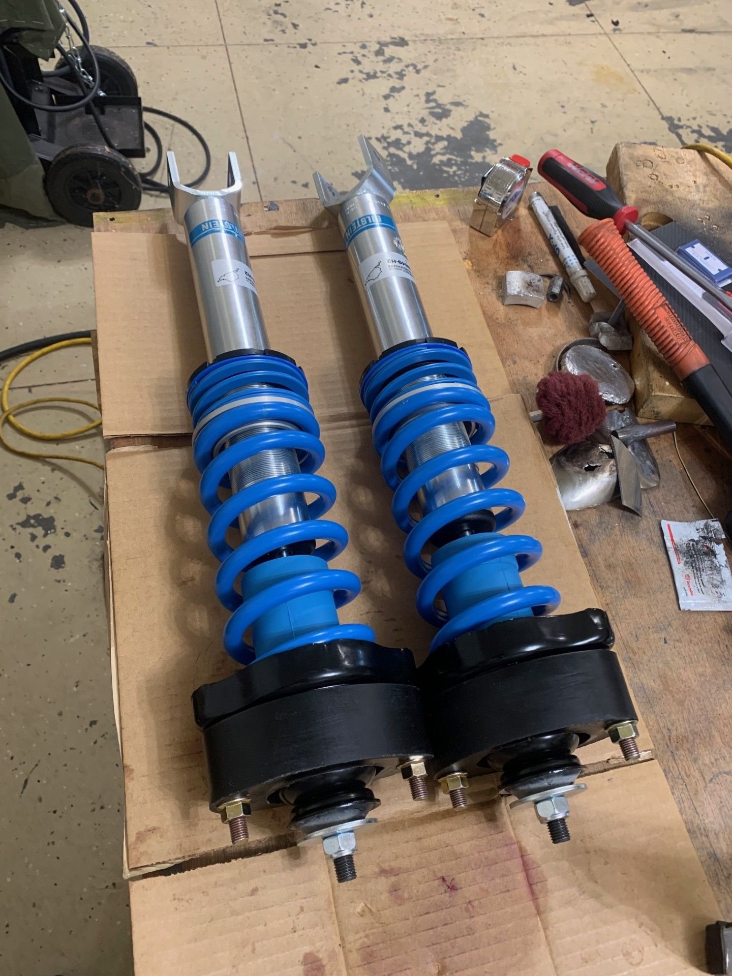

I have the PSS off of Rock Auto. All you need are the front main strut mounts - The three bolt mount off of the top of your old front strut. The rears have a two part rubber bushing that is sandwiched around the steel two bolt upper shock mount. These can also be reused. All of the rear mounts and I think the front mounts are made by KYB and available on Rock Auto. Bilstein includes everything else. The PSS will drop the car 40-50mm at each end. Here are pic's of mine - ignore spacers, I did that to bring car back to normal ride height. 50mm front 40mm rear.
