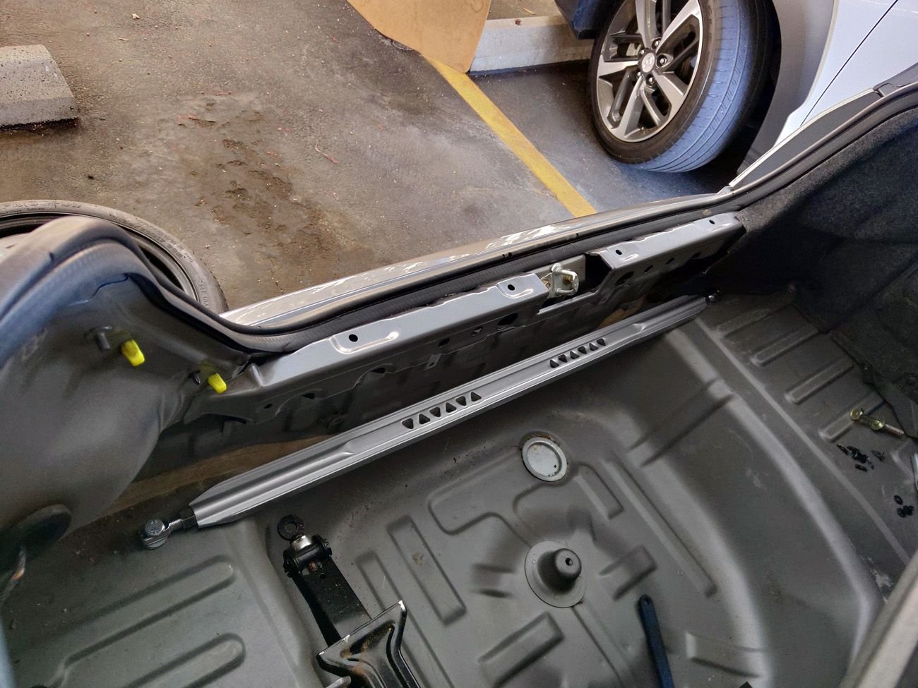

I wasn't originally going to do this because the RS trunk bar is ~$60, and didn't really seem worth it to me just for an accessory. But after seeing this thread, I got a rear strut bar for a Lancer (non Evo) off eBay for $39 shipped. Only $20 difference but the idea of it bolting right up was interesting to me, so I did it. I have carpet on the way and I'm cutting the plastic panel later today to fit. I added a washer underneath each side since the bar touches the trunk before the ends do, so I didn't want the ends being bent down after tightening the bolts. With a single washer everything is pretty flush against the trunk floor. I've only driven it maybe 60 miles, all in the city with some on/off ramps, so can't really speak for any performance difference yet. But for $40, why not

When you put some thought to this trunk bar, the EvO engineers put that bar there for a reason. They must have calculated some level of unibody flex & decided to install a very inexpensive tube bar there, for a later upgrade to those high level track cars? Most of these trunk, strut & chassis bars are not really needed & certainly can not be noticed on typical road driving.
Just my thoughts.

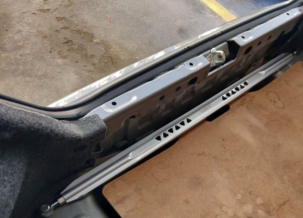

panel trimmed; I cut the tabs off the back of the wood board, and am currently painting/staining it, carpet on order

You made that work! Its actually an upper rear strut bar!
that's what I thought OP was using, but the more I thought about it, it could have been the lower? took the chance with free returns.
So to confirm, yes, you want rear upper strut bar for an 02 and up Lancer (non Evo)
