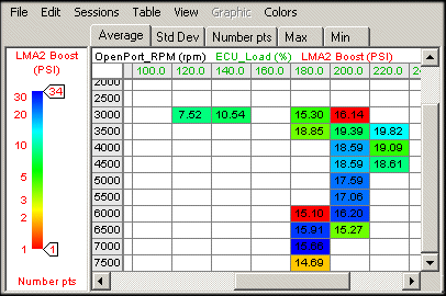

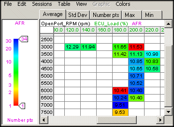

Here is the AFR and boost on my Evo 9 when it was stock. These are multiple third gear logs with load on one axis and rpm on the other. The read cells are single data points and blue cells are multiple data points.
Here is the boost. It peaks higher than what GST has posted, but tapers the same to redline
