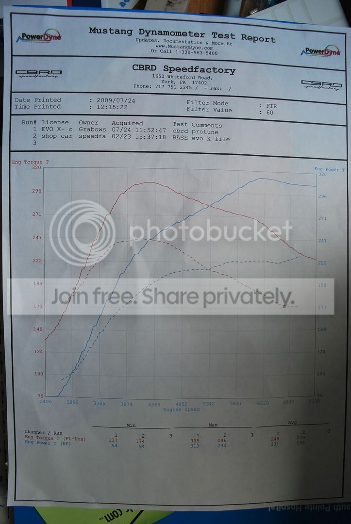

Well I just had the car tuned by Chad at CBRD. Everyone did a amazing job while working on the car. Really top notch. The car produced solid street numbers with crappy conditions (It was about to rain cats and dogs.) Thanks to Chad and team to solve all the issues we ran into. Car is running great.
Temp: 76F
Humidity: 40%
Elevation: 466 ft above sea level
Dyno: Mustang (low reading)
Street tune, 93 Octane, 26 PSI
Made:
305 wtq
313 whp
Filter Value: 60
The numbers were much higher without the correction.
Chart coming soon.
The numbers are not from the highest reading we got during the tuning, but the most stable tune.
Things noticed:
evoDynamics MAC 3 Port needs a lot of duty cycle in the high RPM range to keep the taper down to a minimum almost a 95%. Something like a proDrive or Pierburg/GM might be a better choice, however it does have a quick response.
ETS 4" core, started to get a bit of heat soak after a few runs, not sure if the 5 hour drive to CBRD did not contribute to that fact, even after a cool down session before the tuning.
***Don't mess with the BOV, I had a FORGE RS BOV installed and it was causing a us to throw a p1241 "Torque Limit Limp Mode", while driving the car on the highway. Keep the stock valve. I will conduct furthur tests on the Forge RS, after I cleaned it and readjust the spring tension.***

The chart compares your car to the "shop car" Evo X. How do we know that this shop car puts the same power as your car?
A proper comparison involves baselining your car, tuning it and see the gains.
Eh.... it's close enough. Theoritically speaking, all stock cars should dyno within some relatively small margin.
Regardless, you can still see the shape of the curves.
The base car did not have the same mods as his car. I would like to see how much power the car gained from the tune OR from the parts w/o the tune. This process does not allow us to know how much power was gained from the parts and how much power was gained from the tune.
