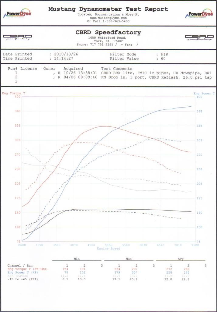

Hello guys!
Just did a 2010 EVO X with the following mods:
CBRD FMIC
CBRD UICP (2.75" one piece)
CBRD LICP (2.5" one piece)
CBRD Test pipe
UR O2 housing, buschur quiet catback
DW1000's
3 port pierburg
CBRD Tune via ECUFLASH
CBRD Tubular Manifold
STOCK airbox
Here is an overlay of the car with the exhaust and 3 port on stock turbo versus now.. mild tune, just under 400whp.. and we are building a cold air intake for the car that I bet will pick up another 10whp....
Slight loss in spool, nice broad powerband!
Cheers
cb

nice,so 25psi tappering to 22psi?

Wow the BBX lite is effing fantastic! Seems like a significant improvement.

we DID change quite a few other things on the car at the same time-
FMIC
IC pipes
and exhaust manifold with downpipe...
But the lite is one of my favorites on the evo X... the BBX full is fun if you want more PEAK high rpm power... but I think the lite provides the best area under the curve
cb

hmmm ive seen this chart b4.

retuned this car yesterday,
slightly less humidity, 1 less psi, made 393whp/341 wtq
ill get another chart posted!
cb
