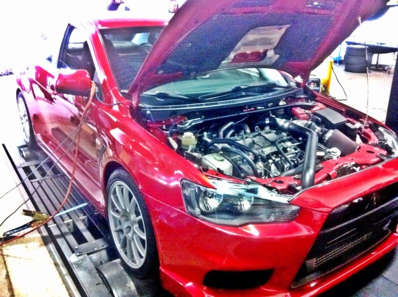

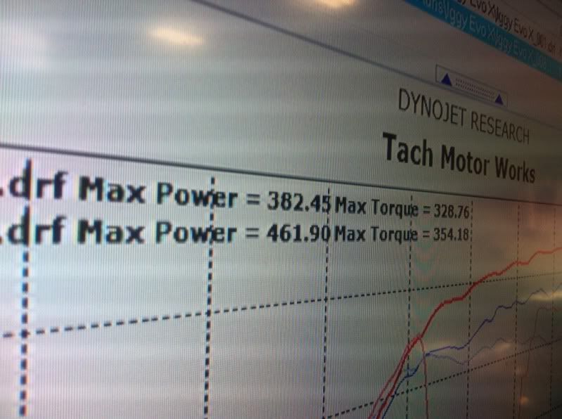

car has the basic bolt ons.
STOCK BLOCK
STOCK HEAD
STOCK TRANS
STOCK CLUTCH 39,000 miles on it
93 PUMP GAS
shearerfab setup. 6262 /82ar. sees 20psi by 4800 rpms (for you little girls complaining about spool)

nice numbers but its like a bomb ready to blow up good luck

those numbers are pretty tamed, soo i dont see an explosion in his near future, but that clutch will go byebye soon, leave that setup as is till you build the block, nice numbers

I don't think this power level is going to blow this engine; his torque is low. The 4b11 is realistically just as strong as the 4g63, with the right tuning, you're just getting haters from the 8/9 camp...
This is a nice setup. How laggy is it on the streets? I bet this is a highway monster.

Please post your full dyno chart, otherwise I will need to move the thread.

What is that huge dip in the graph for?

Loss of tach signal probably.

damn, you are reving it out realllllly far for the stock block / head
edit: nvm, x-axis is speed.

The x-axis is speed not RPM, which happens all too often with DJ's. From what I have seen its usually a tach pickup problem. But maybe they have the RPM graph as well...I just assumed that was the dip and why they did speed instead.

ah yes, I'm dumb. I never seem to notice that
