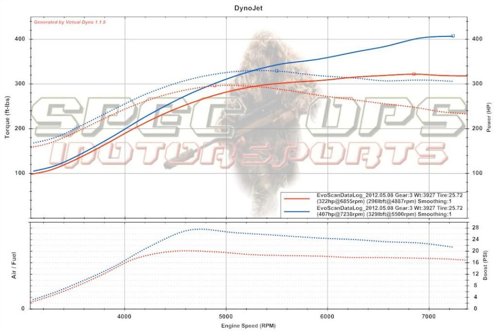

Today Tim made the drive from Charlotte, NC to come have his 2008 Evo X tuned. He bought the car from the dealership and noticed it had some nice mods on it. While I was tuning it, the stock fp took a crap so we had to install a new DW 65C FP. After than, the Perrin BOV took a crap and wouldn't hold boost up top so we swapped it out for a crushed X stock BOV. Good to go after that and he also left the car at 20-21psi that it was set at from when he bought it till he got it tuned. This is his daily and wanted a good reliable tune. He was very happy with the tune and heres the mods we know for sure it has:
-FP Red
-cams ?
-IC piping
-FMIC
-CAI
-FIC 900cc injectors
-DW 65c fp
-Hallman MBC@27psi
-AMS DP
-stock cat
-3" catback
-93 pump
-Matt

Matt, thanks for the great tune. The car feels very smooth and a lot more power then before.

ewww, get that sock cat out of there, its killing your numbers. On my car almost totally stock I picked up 20whp with a test pipe. I bet you'd pick up and easy 20-30whp maybe even 40 depending on how bad its holding you back.
Nice numbers considering though

Powa, Powa, Powa! Glad you are happy sir. I also agree on getting that cat out of the equation. For inspection you can just bolt it back on, easy day.

Nice powa at that low boost level
