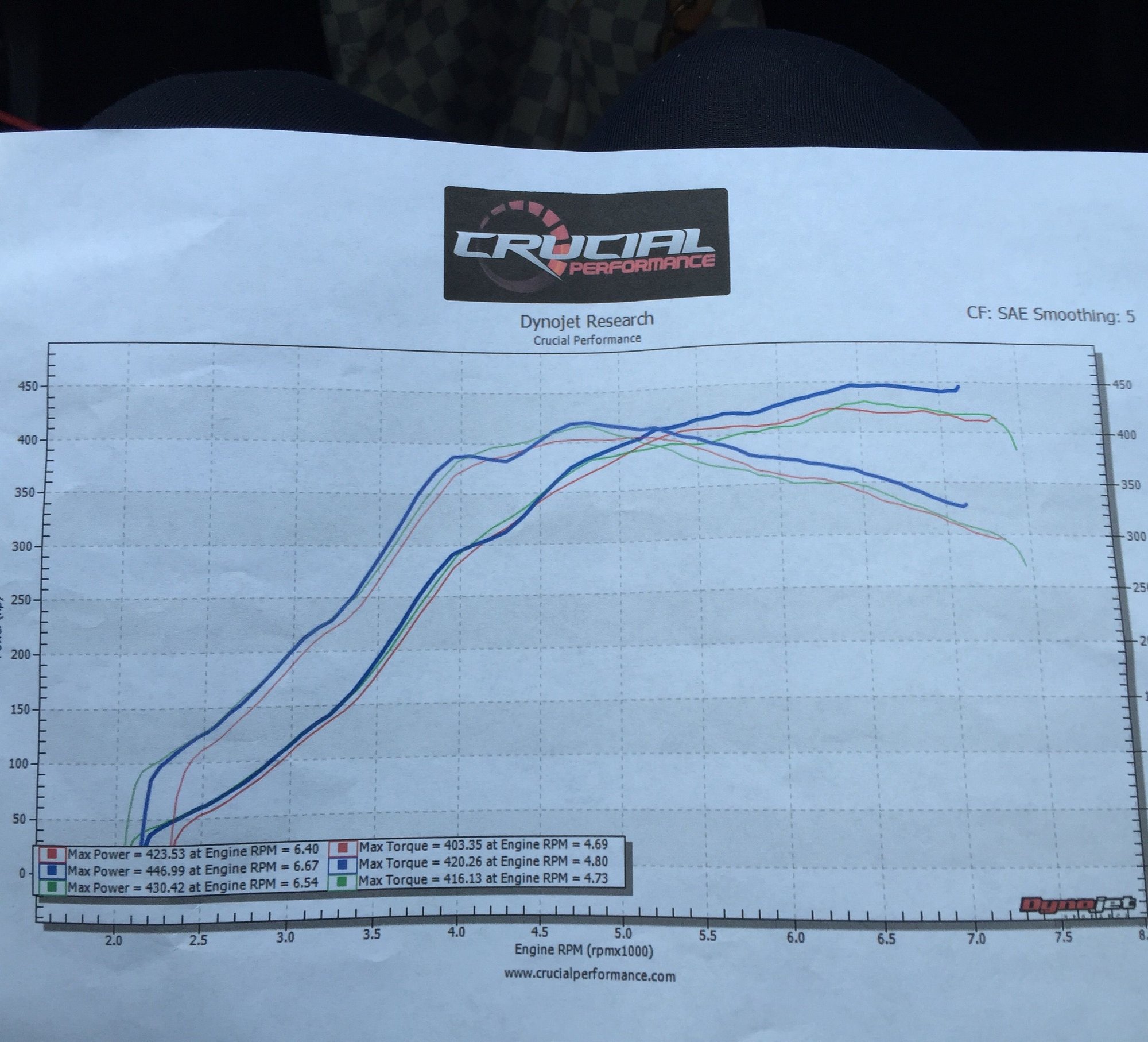

Mhi 18k the little turbo that could...
Tuned by Chet Rickerman e-tune.
Got to get on the dyno for the first time here at Crucial Performance in Columbus Ohio.

Nice. 93? Or e85?

E85 1000cc injectors

Nice I love my mhi! 420 wtq is pushing but I bet that hit at 4k feels great... I am at ~440-450whp/370wtq on mine.

Something is off those are stock block/ stock cam dynojet numbers. How much boost are you running?
I would expect that setup to be pushing 480-500

lmao thats hilarious. I'll agree, the spool feels the same as stock but punches way harder. Go get that thing on the dyno.

I hit max boost of 33psi @4200rpms and tapers to 32psi until about 5800, then it drops to 25ish till redline. My ceiling is my 1000cc injectors. They've been maxed and Chet is just working with what I have. I can't really speak for others results with stock block/stock heads. I know all dyno's read a little differently.
