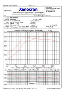

My current build is a built 2.0L with Wiseco pistons, Manley Turbo Tuff cons and a polished crank all with ACL bearings. Piping is all AMS with 1100cc injectors and I believe a Walbro 255 pump. Head is stock and I just recently put on an Akrapovic exhaust. Those are the big things I can think of but I may be missing some things. I plan on a 2.4L long block build to go along with a new slightly smaller turbo than my current EF4. Will also be doing a built trans and t-case. Just got a baseline tune that I'm pretty pleased with so I can drive the car until I pull the trigger on the build.

I am confused. Built motor with an EF4 on 93octane making 350hp ?

Forgot to mention.. supposedly that dyno is about 15% weak compared to DynoJet but I didn't want to say that because I can't prove it. Before I bought it it was making roughly 410 the new tune just smoothed out fuel mapping and makes peak boost quicker now. Boost is closer to 26psi now as well.

I am not trying to be a jerk or negative, but that still seems crazy low. What is your baseline on this dyno? If you don't have baseline for your car, perhaps the dyno database has info for a typical EVO baseline. For reference, I made 220hp stock and 402hp (both using VD) with nothing more than a spicy 20G on 93 octane. What did your boost curve look like?

Yeah totally understand where you're coming from. It's a build bottom end so really the only thing that comes with that is reliability. It's also a conservative tune where full spool hits at 3800 and is limited to about 25-26psi. The statement of the dyno being ~15% off lines up because the before and after power on this dyno was about 350 and on the previous tune the other dyno read 410. This tune is more for smoothing out the fuel mapping/boost and verifying where I'm at with the car. Now I can probably push it to 450-465 before building the head but I'd have to up the boost, increase octane or do some other funky things. Without the built head I'd think the limiting factor quickly becomes Flow in the head as well as things like non ideal swirl and squish from the stock valves and valve float from the springs.

I was starting out being gentle with what appeared to be quite poor results.
That has now gone out the window..
Unless the baseline was 50hp at the wheels stock, it seems that you have a built shortblock and massive turbo and not really using either of them. I am also confused why you would start a NEW block build to a 2.4 when your current built block hasn't really been taken advantage of at all You actually stated it was a "baseline" tune, and then your going to call it quits with poor results and tear into it for a 2.4 build with a SMALLER turbo ?
Everything seems

First that's not how proportionality works and I hope you're using hyperbole. If your dynojet was reading 220 factory my dyno would hypothetically read 190. Original tune when bought read 405. Same tune when on new dyno read 352 if I remember correctly with no changes and a healthy engine. There is where you will find the difference percentage wise. Next I bought the car with the built 2.0 but that is not why I bought it and have always intended on a build because that's what I'd like to do with my car and it will better suit my long term goals. With a 2.4 I can have power on tap and not be solely reliant on a giant turbo for power nor will the lag be an issue. At a later date I can add a larger turbo or a different octane tune for more power.
