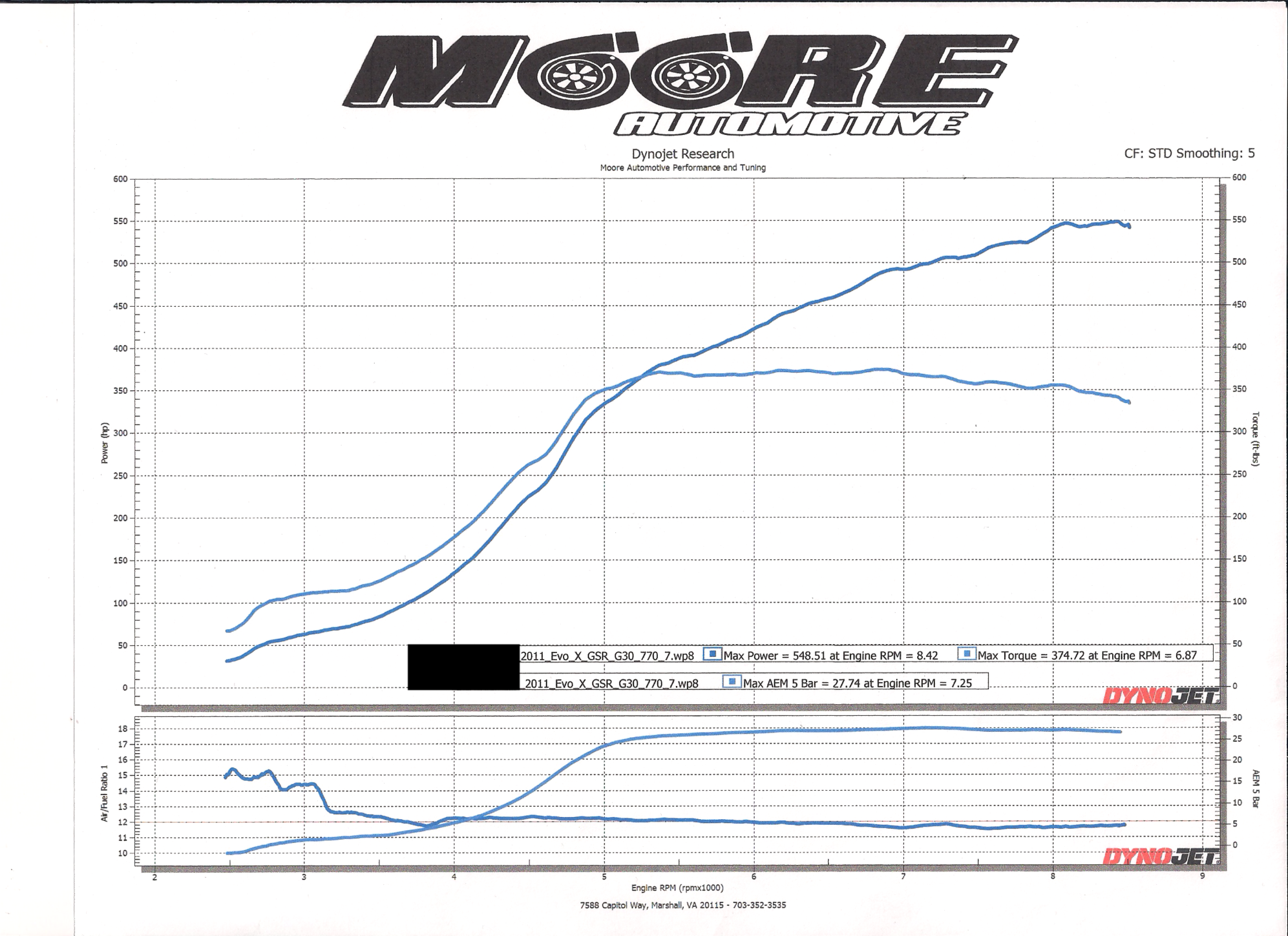

Hi Everyone,
I am the original owner of a 2011 Evo X GSR. I've gone through multiple iterations of mods including FBO, upgraded turbo/manifold, etc. Last year, at 60k miles, I started experiencing smoking from my exhaust at startup/idle. After compression and leak-down testing, the engine clearly needed some attention and I decided to go all-in on a full build.
I had Moore Automotive in Marshall, Virginia handle the build and tune (Thanks Paul & Chris). The machine work was handled by AR Fabrication in Virginia. The build was completed last month
Below are the build details and dyno graph.
Engine Build - Bottom End:
  • 2.0L Darton sleeved block
  • Wiseco 86mm pistons
  • Manley Turbo Tuff I-Beam rods
  • ACL Race rod bearings
  • ACL Race main bearings
  • ARP main studs
  • Fluidampr crank pulley
  • Piston coatings (Calico - tops & sides)
  • Bearing coatings (Calico)
Engine Build - Head:
  • GSC 650HP+ valve train package (valves, seals, guides)
  • GSC S2 cams
  • GSC valve springs
  • ARP head studs 625+
  • Cometic head gasket .044" 88mm
  • Magnus MIVEC delete cam gear (exhaust)
Turbo & Intake:
  • ETS G30-770 turbo kit w/ 4" intake
  • ETS turbo blanket
Fuel System:
  • Injector Dynamics 1300-XDS injectors
  • DeatschWerks DW300 fuel pump
  • Torque Solutions fuel pump holder
Oil System:
  • MAP oil cooler kit
  • MAP catch can w/ drain kit
  • OEM oil pump & chain
Clutch/Drivetrain:
  • Exedy twin disc cerametallic
Pretty happy with the performance right now. If I get bored, I'd do flex fuel next which would probably yield another 75whp+ and 50wtq on this turbo setup or more.

Are you running the stock trans gear ratios? Wondering how much difference it makes reving out another 1k
Old Nov 14, 2025 | 10:15 AM
mar387's Avatar
Joined: Sep 2010
Posts: 173
From: NJ
Yup, stock transmission. Still getting used to the car and didn't really question where I'm reving it out to based on where it's making power/being built.

Gotcha. Well that 5-8k rpm powerband looks hella fun!

Yeah, it totally rips. I was trying to find a balance between responsiveness and decent power. I'm coming from a Borg Warner 7163.

This is on 93!? Great numbers, and fantastic build. E85 is a game changer, people forget that 30% more fuel means MORE exhaust = faster boost!
You will make another 100whp easily!
Post some vids of this beast in action; street, strip, dyno, etc!

Yessir, this is on 93. I didn't want to necessarily depend on E85 being in New Jersey and there aren't a ton of places to get it conveniently. However, it's hard to not want flex fuel. I'll post some videos soon - probably should get a camera setup.
