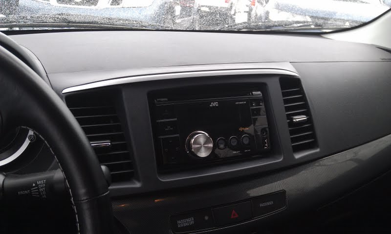

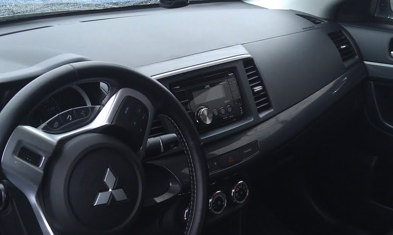

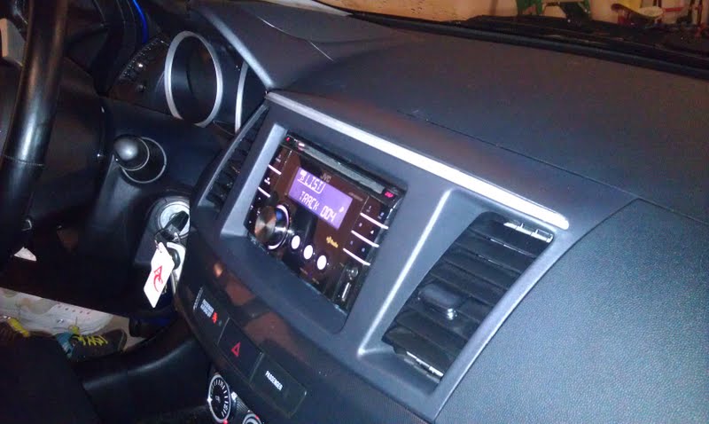

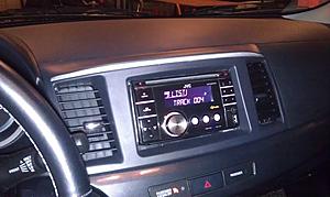

What did you use to mount the head unit? If I use the stock brackets it sits far too low to fit the dash kit.

I used the stock brackets. Are you using the right holes on you aftermarket HU?

Here are the install pics. Thanks for the help guys!
Attached Thumbnails American International Dash Kit MITK-894-1.jpeg   American International Dash Kit MITK-894-2.jpeg   American International Dash Kit MITK-894-3.jpeg   American International Dash Kit MITK-894-4.jpeg
If you have the stock non-Navi/RF head unit, you'll need to order the Mitsu navi bracket.
It is part # 8701A168 ..I ordered mine from Russ @ Mitsubishiparts for ~$18.
Other than the Mitsu JDM kit, the American Int'l kit is probably the best one on the market right now. Installed mine last summer, and fitment is around 9/10 with just a slight gap at the back of the top piece. Was near impossible to order back then.. had one of the AI reps hook me up with a local shop down in FL.
I actually modified my non RF brackets slightly and got it to work. I was originally a little freaked out when it didn't even come close, but I figured it out along the way.
