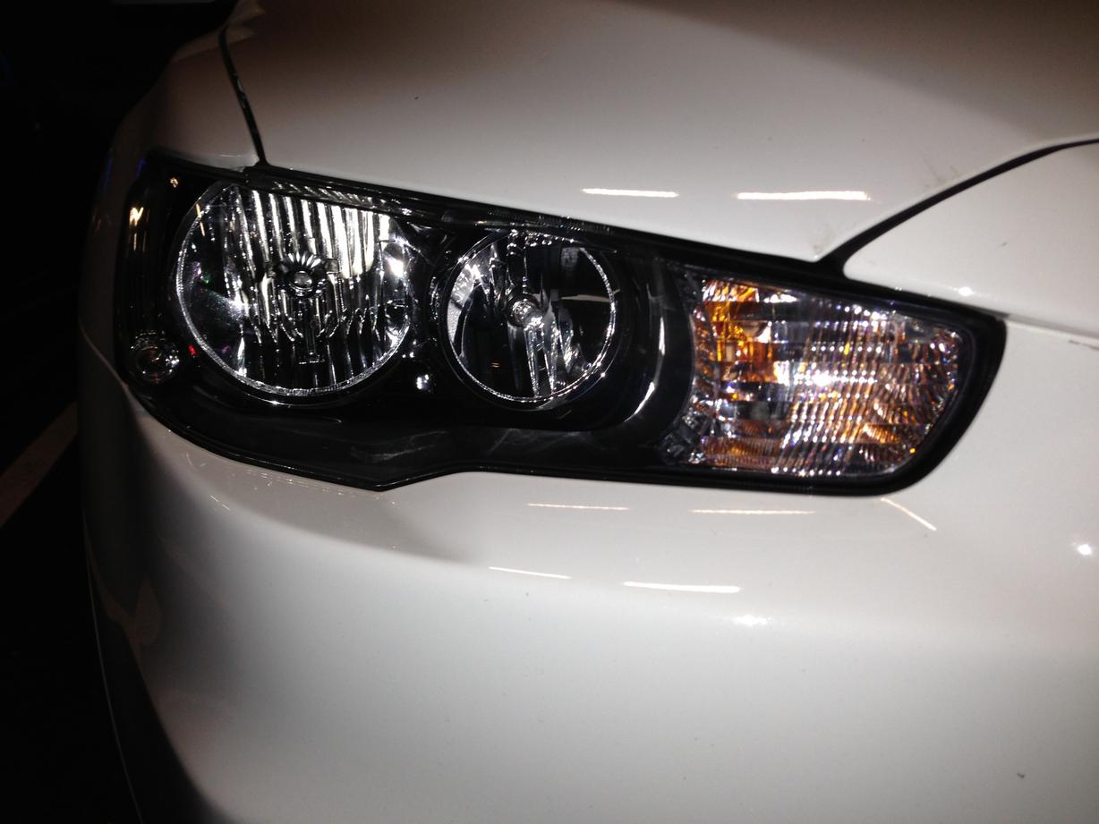

Old Oct 24, 2013 | 06:19 PM
EvilRob's Avatar
Joined: Oct 2007
Posts: 618
From: Michigan
Post a picture of your lights
Old Oct 24, 2013 | 07:11 PM
x4me's Avatar
Joined: Oct 2013
Posts: 7
From: san diego
Here ya go

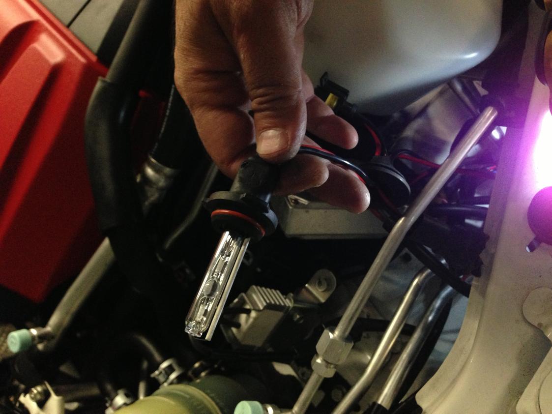

Old Oct 24, 2013 | 07:13 PM
x4me's Avatar
Joined: Oct 2013
Posts: 7
From: san diego
Here is what the part looks like.

Old Oct 25, 2013 | 11:10 PM
zsak's Avatar
Posts: 96
just buy oem halogen bulbs that will fix the problem. Those are aftermarket hids and probably cheap ones
Old Oct 26, 2013 | 06:19 PM
JP3NS's Avatar
Joined: Nov 2011
Posts: 91
From: Staten Island
If you have drl (daytime running lights), which i believe you do, then you will need to use jrox harness to run hid's without flickering. Jrox is a member here so contact him.
Old Oct 27, 2013 | 03:05 PM
x4me's Avatar
Joined: Oct 2013
Posts: 7
From: san diego
I can just throw in some oem bulbs without any modification?
Old Oct 28, 2013 | 08:16 PM
zsak's Avatar
Posts: 96
you should unless previous owner seriously messed up the hid kit install. the hid balast and bulb come out and you install new halogen bulb then success
