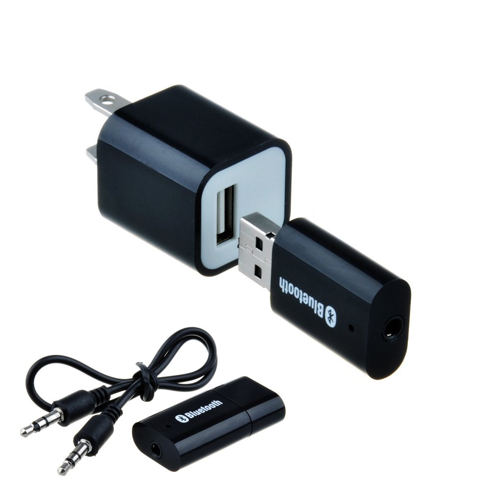

wouldn't the easier way be to get a Bluetooth receiver, DC adapter, and plug it into the AUX RCA jacks (probaly would need a mini stereo jack to RCA adapter also)?

i got lucky previous owner had this wired up, i bought this
Amazon.com: Miccus Mini-jack RX: Bluetooth Music Receiver pair it with Phones, Tablets, PCs and Apple Devices: MP3 Players & Accessories Amazon.com: Miccus Mini-jack RX: Bluetooth Music Receiver pair it with Phones, Tablets, PCs and Apple Devices: MP3 Players & Accessories
plugged it in and bam i got music from my phone and still can take calls off the built in phone.

i got lucky previous owner had this wired up, i bought this Amazon.com: Miccus Mini-jack RX: Bluetooth Music Receiver pair it with Phones, Tablets, PCs and Apple Devices: MP3 Players & Accessories
Just wanted to co-sign that this product works wonderfully, i've been using it for a year and a half with my tablet setup on my '08.
