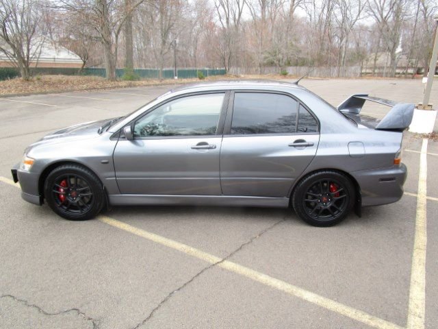

So I've changed my DRL to the RED LED 1156, you can find at autozone.. And apparently my right side wouldn't want to turn on .. Power works if I put back the original bulb that I bought the car with which is bizzar..
I posted pictures but idk if it'll upload the actual pictures since the picture shows something that isn't what I uploaded.. Weird..
