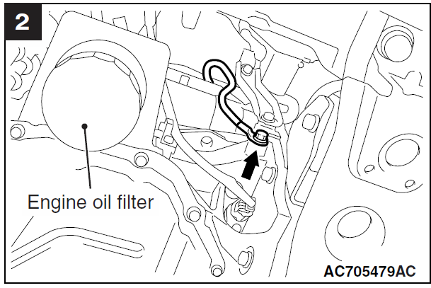

I'm putting a X GSR back together and I can't remember where this chassis ground cable goes connected to. I have searched the site and checked ProDemand and cant find a solid answer. I'm pretty sure it just goes on the engine but I psyched myself out and want a solid answer before proceeding. The cable starts on the driver side of the engine by right under where the intake would be and is routed with the starter loom. The cable has a clip on it which is connected to one of the intake manifold hold brackets. I'm including a picture so hopefully someone could give some useful input.

It looks like it bolts to the block right by the oil filter housing

Perfect, Thanks.
