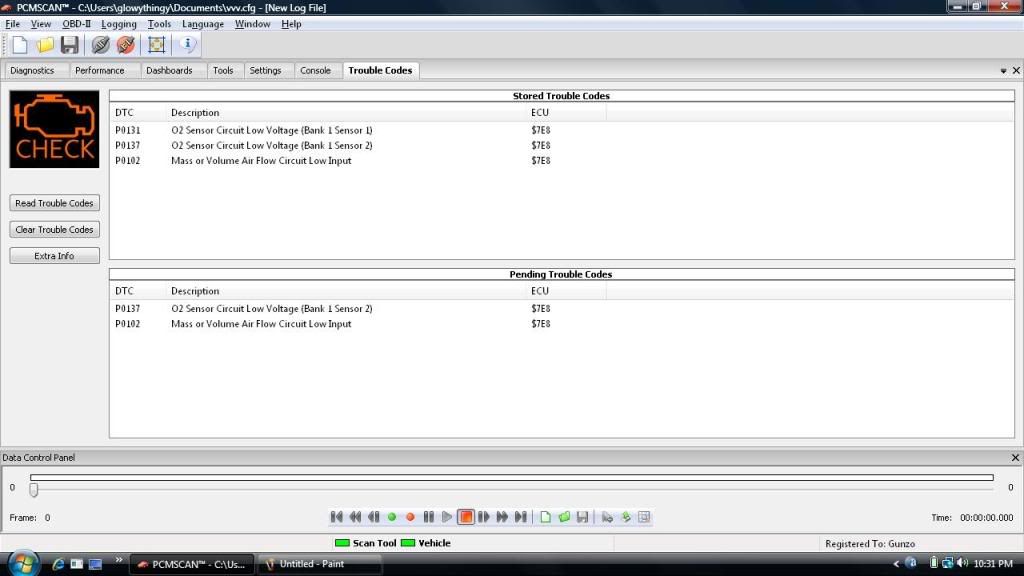

every time i clear the SES P0102 comes back instantly.. here's what it had on it after i drove it for a bit and let it sit.

From: Melbourne, Australia
time to get out the DMM and test the voltages coming out of the MAF.
I would say either it needs to be cleaned or is actually faulty
