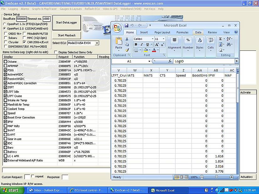

Does anyone know if we have the ability to log Boost error yet?

Yes in Evoscan just click box. (mode23)
See picture.

Hmm.. I must have an older data.xml.
In fact I remember, I only have mode23 items listed. Are these native mode (non mode23) items as fast as mode23?
I guess I need to find the most current data.xml file available

I have it, I log with mode23....
Your screenshot of boost correction looked like a non mode23 item
Can you post your data.xml file in case I don't have this? I'm not at home right now to check

Now this is my Data.xml for evoscan 2.7
Well It's mode23 because if it was not I would not be able to log any of this things.
