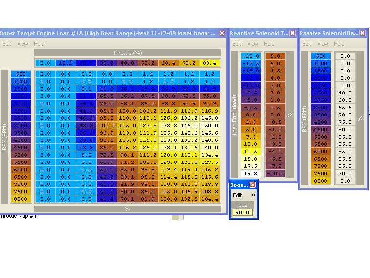

I was looking at your log and your PSI sure rises and falls a lot man. I mean from 26-22 back to 26psi.
Check out mine. (Now this is my winter boost setup)
Also at 5000ft too. 91oct
