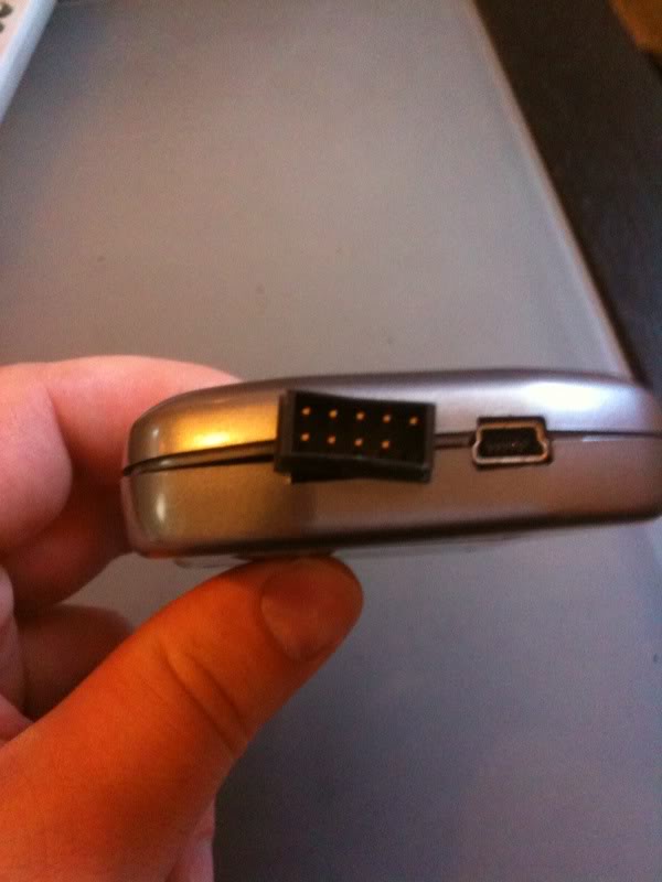

So I finally get my AP back from Cobb in Utah. It took almost a month, but whatever. Well I open it up, and this is what I see.
To say the least I wasnt happy with the way they repaired the OB2 connector on the bottom of the AP .... and I think you can see why. I dont see how a quality control guy, or even the technician that fixed it could let this leave there facility and be sent back to the customer. So not only does the repair look like crap, but one of the pins ended up breaking after about 10 minutes of using it. I was able to get one reflash completed before it crapped out again. You can see the bottom right pin is gone. This is probably due to the extra stress on the connector due to it being all twisted.
Im not looking to bash Cobb and say there products suck... because they dont. But Im just really disappointed with the way this supposive repair went. I did not cause any damage to the unit either this time, or the first time it stopped working. And the first issue was an internal connection issue..... now this. The one reflash I did is a revised map that Ivey had sent me due to my LTFT acting up. Now I cant even check any data to see if the knock is ok. Nor can I flash it back to the last revision which I know is safe. Ill be on the phone with Cobb first thing when they open.
Anyone else come across this or see anyone else's AP come back in that kind of condition?

I have had issues connecting the AP occasionally after an update, on both mine and a friends car. After doing a re-install of the ATR software, the issue has gone away each time. I have only had this issue after doing an AP firmware update.
As for the messed up looking AP, ouch. I'd be pissed too. Looks like they converted it to v2, and the plug didn't fit or something. Wierd.

After finally getting through to Cobb, we were able to figure out that the screen is actually busted. It powers up through the USB port (checked this with AP manager) but not sure if it powers up through the OBD2 port because the screen wont come one.... so your unable to tell. As far as the pin missing... apparently thats how the new ones are coming from Cobb. Chris from Cobb explained that all the new ones dont come with that 10th pin. They must have removed it while doing the original repair. Needless to say, I have to send it back to them. At least their paying for shipping both ways this time. I just hope it wont take another month to get it back...... but for some reason I think it will.
