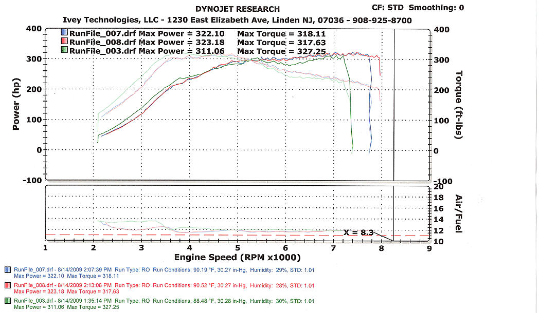

I have a dyno graph somewhere. Lemme find it.
Here ya go. The green is Perrin stage 3. The car was running a bit lean under 4k rpms (13's A/F) but it was a torque monster down low and felt great. This was w/ a K&N drop-in, so it would probably be fine w/ the stock filter. It was a good map and I ran it for a few thousand miles.
By the way, it was over 90 degrees during this dyno session, and I had literally just driven 7 hours to Ivey's place, so no doubt my motor and intercooler were pretty heat soaked.
