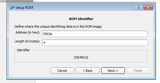

So i tried downloading the stock ecu map however once the download is completed i get the error "unknown rom image" followed by a dialogue box. I tried to save the image and every time i open it i get the same unknown rom image error. I dont know what the rom id is however i get this dialogue box followed by the other. Is the identifier the inherit? The car is an EDM spec EVO X from what i know as most of the evos here in Dubai or Middle East are EDM spec. Do i need to download the particular xml and put it in the rommetadata folder for this to happen??

The ROM ID is 53040010 as shown in your second screenshot

yup sorted this out..i got my hands on the xml files thanks to golden!
