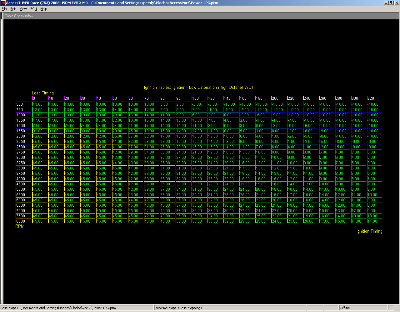

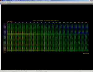

3. Timing
- LPG burns slower than gas at low RPM/load, so you have to add a few degrees in this area (I added 2-5 degrees over 93oct gas). Otherwise you will not get ideal power and your exhaust valves will be worn quickly.
- On the other hand in high load/RPM it burns faster, so you may need to remove a few degrees of timing there to avoid knock. I had to remove 5-10 degrees in 1000-2000RPM in load over 70. Also removed 1-2 degrees near redline.

I completly remapped the ECU (most the timing advance map-you can see a picture above, completly the MIVEC maps, AFR map, reactive selenoind+target load map and minor changes to others), so that now it work perfectly on LPG but if I want to use petrol for longer driving (not only to get to petrol station), I would have to flash petrol map back. Having 2 different tunes in ECU and being able to switch between them is the best way - search Tephra MOD X thread on forum, there was written a lot about this. I do not use this as my tuning software is not capable of it.
I also use WB to keep my AFR in cruise at lamda 1.1 which means AFR 17.1 on LPG.

I do not really get your point about the timing, you said you need to add timing in low load/rpm but then talking about "I had to remove 5-10 degrees in 1000-2000RPM in load over 70"..
Is really that drastic change needed by the way? I do not believe the companies doing the LPG rebuilds modifies your fuel maps/requires using 2 maps... even at turbo motors.
I got 4g63, that is different motor, but I was just curious about your previous 93 map to see the difference in related/touched timing map areas..
Thanks.

But in RPM below 2000 and load ABOVE 70 I experienced persisting high knock count, that´s why I had to decrease timing a lot. However as I sad, this is not area where you should get often.
You are right, workshops rebuilding to LPG usually do not do any changes to timing, because they would have to have possibility to reprogramm stock ECU - and tuning the timing map on dyno for every rebuilt engine would be very costly to customer.
The rarely use additional timing computer (but these "computers" just increase timing by adding constant degrees of timing to the whole timing map while the engine runs on LPG, which is wrong, because LPG burns much slower in low RPM/LOAD, but faster in high RPM/LOAD than petrol)
So if you do not do any changes to timing, the engine will run, but not with ideal efficiency and you may encounter high knock in some cases.
