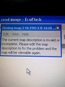

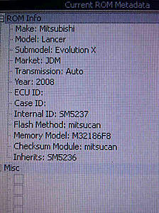

I am trying to help my friend (he can't speak english). He is having a problem with ecuflash when he tried to read this 2008 EVO X JDM ECU with SST trans, the message box said that "The Current Map Description is invalid or incomplete. Please edit the map description".
I attached some pics from the ecuflash error messages.
Please would you kindly help, how to solve this problem. Maybe, is there any new
file to fix it?
Thanks in advance

Go here:
http://goldenevo.com/
Download 52370023 and 52370024
You may have to delete your file named SM5237.xml

Thanks a lot Golden. I'll download it and let my friend try it, Once again thank you

Hi Golden
My friend already tried using those 2 files and delete the SM5237 but the ecuflash still giving the same error message.
Do you have any other suggestion how to solve this problem?
Thank a lot

He needs to delete the bad file. There is no way for me to tell you which one is bad, you just have to look for it.

Ok Golden .. thank you for the hints .. let me tell him about it ..
