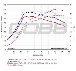

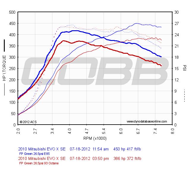

It's not complicated... which line on the graph do you prefer?

lol In the words of the great jay-z men lie, women lie, numbers don't hahahahha
no need for an argument and where I live e85 is 65 cents cheaper than 91 I had my wife check earlier today...

well this should settle the debate nice numbers man
