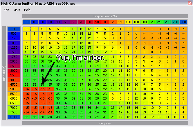

I have been wondering which map of the tuning is really "enabling" this feature. Is it ignition timing... like very advanced timing under low load (like the picture below)? Or could that be it's something other than the tune, like camshafts and valve timing?

Timing is retarded in the table pictured, not advanced. And yes, that is what does it...
emphasis on the retarded

LOL.. I did it on my car for a while. Makes for cool pops and bangs on decel. Got annoying after a while though.
