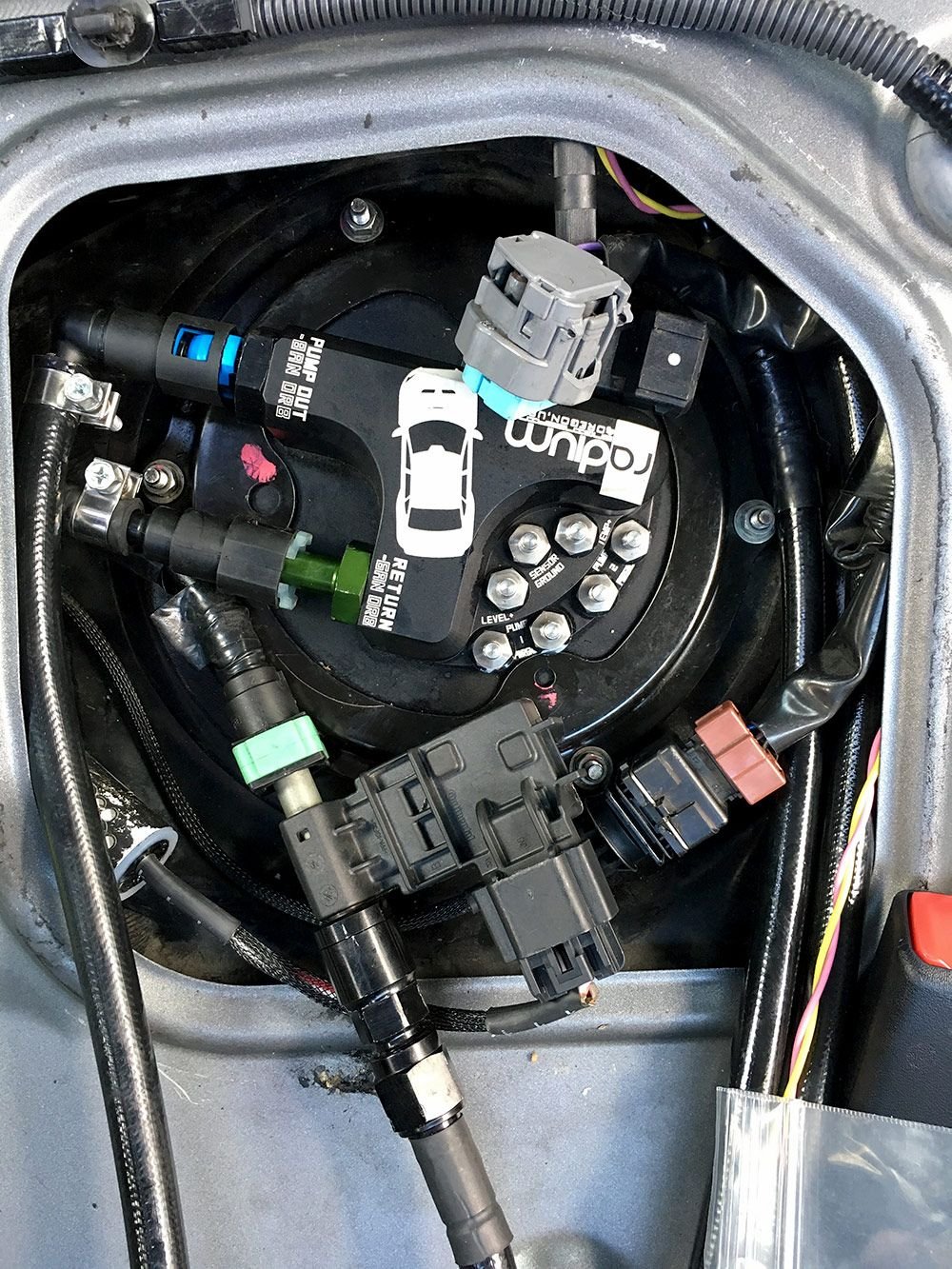

yes, use a normal fuel rated hose with fuel hose clamps (the smooth ones)
Like the silver clamps I have on in this photo:

Perfect. Thanks for the advice.
