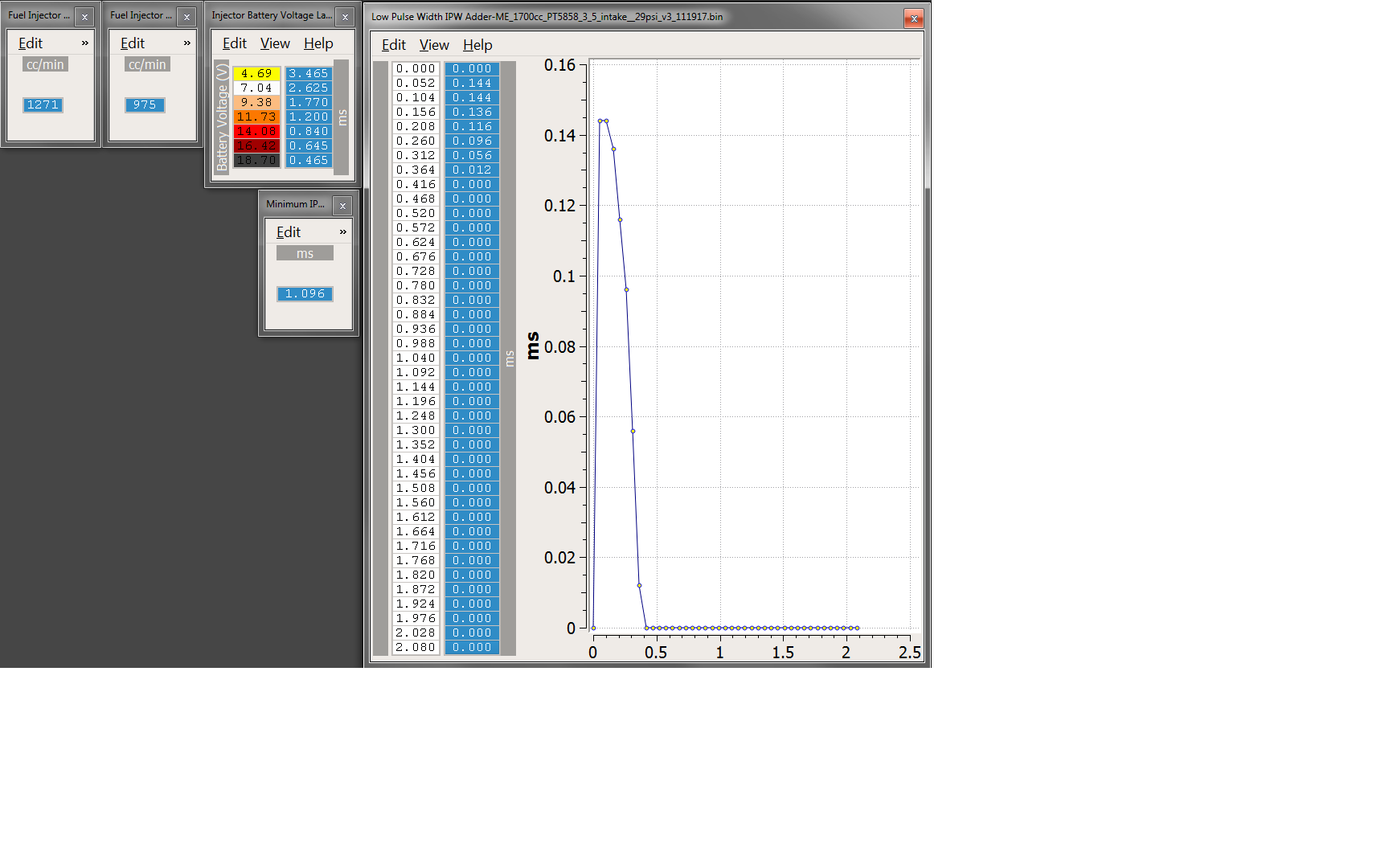

Have you tweaked your low pulse width IPW adder table at all? It's pretty much mandatory with ID1700's. Also assuming you have already done the Min pulse width rom tweak so the injectors are able to idle at lower pulse width?
Here is how I have mine setup. It got rid of all my part throttle issues that where close to the same as what you are describing.
As far as idle. I have S2's and it purrs like a kitten at idle. Basically zero lope. This also has a lot to do with how your mivec tables are tuned.
Idle, this is on E85, but you get the idea

Bryan's post is very useful for you to adjust your injector maps.(it is just for ID1700).

  1. new fuel related maps "Low Pulse Width IPW Adder" and other injector maps probably useful for your issue.
