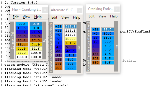

I am having trouble starting the car on E17 after the car is warmed up. I assume it was the cranking IPW addr (could be wrong). I am on FIC 1650's and tephra flex, ran great this year on E80.
I noticed the tables are not matched for entries (base 93 is 9 entries and Alt #1 for flex is 11 entries). I am thinking this could be the problem.
Here is a shot of the tables:

I didn't realize I never updated these tables, and late last night I cooked up more appropriate values and she ran/started like a champ today.
I would still like to know if it is normal that the tables have a mismatched entry count....
