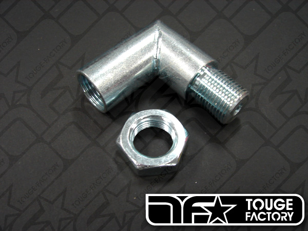

Old Sep 16, 2008 | 11:11 AM
Touge Factory's Avatar
iTrader: (149)
Joined: Jun 2008
Posts: 549
From: Chicago
We used this on our AMS test pipe on our X, and the CEL went away by itself the next day...
