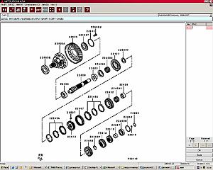

the mits part # of the diff is 22630a gear and diff assembly. My car had 10,xxx miles

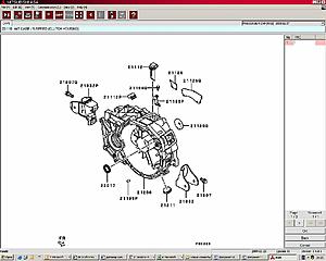

Thanks for info, very helpful. So, 22630A is the diff only or is it the whole thing - no assembly required?
Also the damaged piece of casing is the one on the attached chart, or is it a different part?
Attached Thumbnails X rs gearbox....-image005.jpg   X rs gearbox....-image007.jpg

The 22630a is just the pumpkin, the part number points to it. It has spyder gears and everything in it. The housing Im not sure what number it is from the pic or what comes with it.
