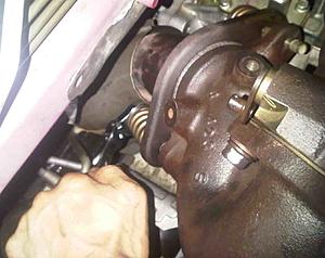

2 choices/options for ya hope it helps
1. just use extensions (15" shud be long enuff) and wobble to remove them. i find the one the left is a little more difficult to remove but it's possible. just try diff angle to get to it.
2. depicted in pic below hehehehe ... but be warned, yr 14 mm angled wrench might get stuck in between the DP & heatshield and it is VERY difficult to get it out i used this technique during re-installation of stock DP.
