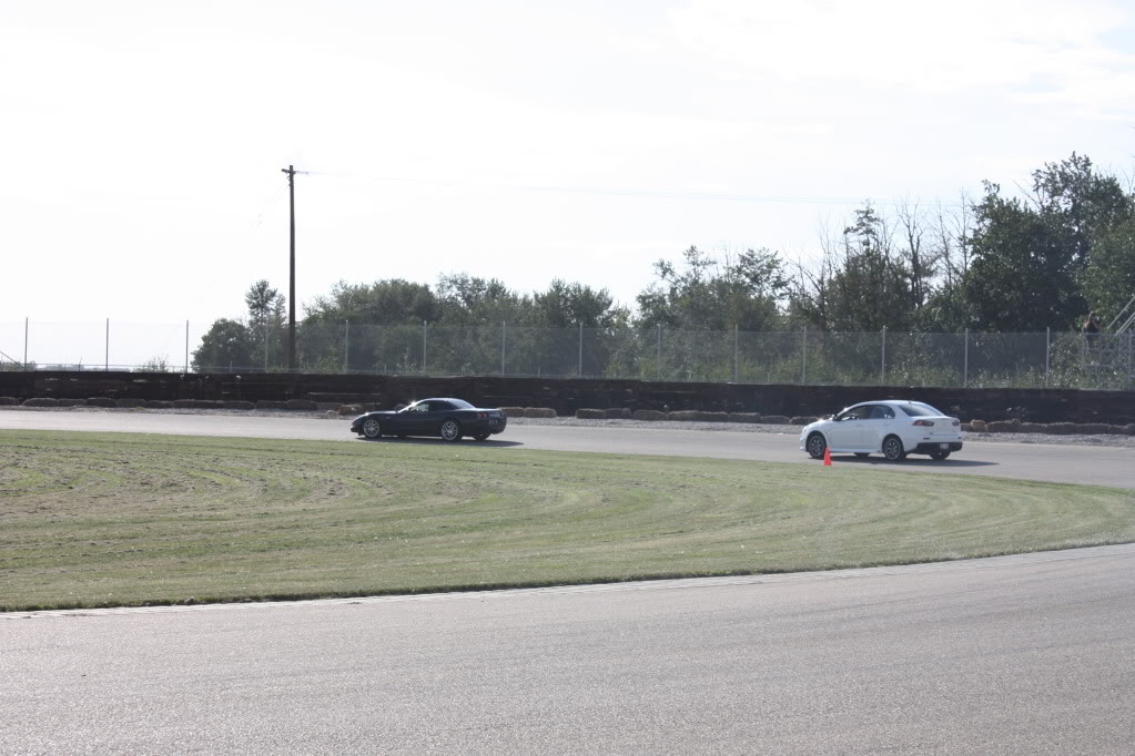

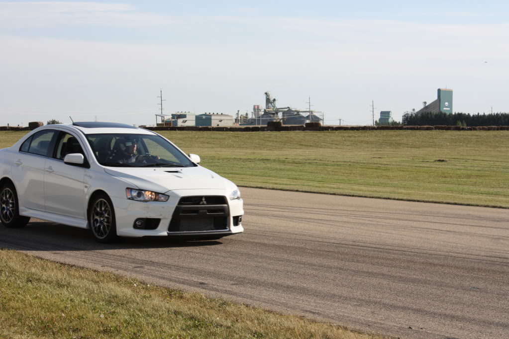

ps the above picture.. we had cones marking breaking points apexes etc.. this was a local sports car club meet with avalible driving instructors etc..

yeh ASC is annoying and can be to aggressive particularly over a bumpy surface...
BUT it is also a life saver..
IF your going to "play" make sure you have PLENTY of spin of area (on both sides of your exit line)
^ that run off on the inside looks like a dream

the fence line is pretty much next to public roads... last season a viper boiled it's breaks after(in the breaking zone) the long straight and floated over the gravel trap through two hay bails and in to the fence in the ditch only 6 feet from a highway LOL he was one lucky dude!.
