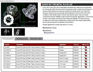

As the title says can it be done and what would need to be completed in order to achieve this setup?
Not sure if i'd have to modify abs/ayc systems? From what i've read i think i have to do an AYC delete correct but can i keep the abs?
I've been researching for a few days and have not come across any MR's with the RS diff swap i've only seen GSR's do it with some minor modifications.
On RalliSpec i saw they do have the SST Models of the RS Evo X diff's which made me interested.
Would it be worth the bang for the buck since they don't sell the RS model here?
Any help/tips is much appreciated!!

I know of no differences in the rear diff or AYC between a USDM MR and GSR, so I'll assume that you're talking about the front diff. I don't see any issue here, other than ordering the right part, but have to wonder why you're doing this. If you're setting up for rally, then getting rid of the AYC entirely is the first step. If you're setting up for pavement, then most seem to stay with the helical. So why do you want a 1- or 1.5-way front?

I'm setting up for an auto-x/track car I don't plan on taking it off road. Figured it would strip a lot of weight out, handle better, and be more durable compared to the stock electronic difs. I see time attack evo x's with no ayc and 8/9 diffs swtapped out. Haven't seen any MRS which peaked my interest, I wonder how it would feel. But the cost to outcome is what has me wondering if it's worth it.

My suggestion, then, is to leave the front diff alone (because a helical is usually better than a 1-way on pavement; just learn to left-foot brake, if you aren't doing this already) and maybe put an RS in the rear. The AYC is really something to keep for road racing. It's why we turn better than many other cars, especially Scoobies. What you really want, IMO, is a good ACD/AYC tuner. The OE programs stink. I especially hate the inverted AYC when you launch into a 90* turn when autocrossing. That must be tuned out. If after a good reflash of the ACD/AYC you still don't like it, then start swapping hard parts.

So the front hellical dif is better than a 1 way RS or 1.5? cool saves me 1.5k
I see that MoTec has an ACD Controller on there website could this help difficulty with finding a tuner to successfully tune it with no issues?
http://www.motec.com/mdc/mdcoverview/
Don't plan on swapping it unless it's somewhat achievable.
Definitely don't want to buy the dif etc. and not have a way to swap it successfully.

With the Full Race ACD-Pro it would allow for the AYC pump to work with the system how exactly could i find someone to tune it?
Do you think it would be something STM could do?
What do you think would perform better with the ACD-Pro unit installed a RS 1.5 way or 2 way? only AYC models diffs offered by Cusco
The Transmission is stock right now.
Also will be taking it to the strip besides auto-x/road racing events.
Thanks for all the info!

Looks promising
