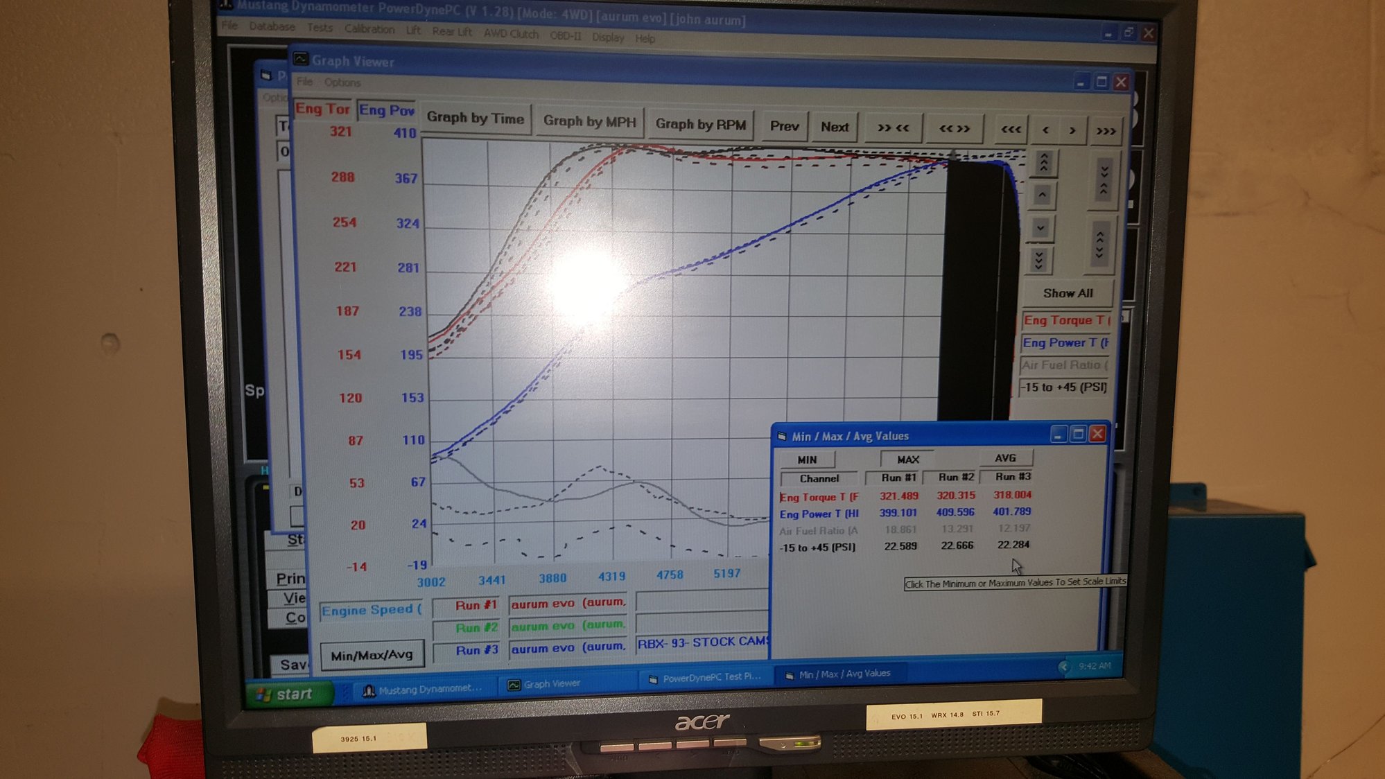

Hey guys. I finally got my CBRD kit installed by CBRD. I just wanted to thank Chad for great customer service and very nice results. The car pulls like crazy and it is a blast to drive. Even after a week I still laugh like an idiot every time I get on the gas. The shop is top notch and Chad knows his stuff. He answered every question I had, and was very patient with all my requests. Excellent job, great results and overall just a great experience. Thank you
Here is a picture of the dyno results:
