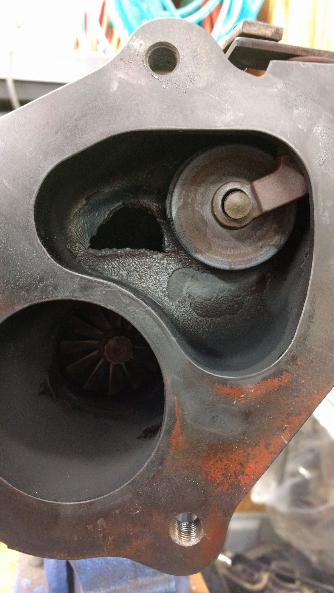

Hi all, I've got a stock Evo X turbo with severe damage to the turbine housing. Aside from the housing the turbo appears to be in good shape and despite the damage was still making 20+ psi when I removed it.
Does anyone know where I might find a replacement housing or know of a shop that can repair it for me? Seems like a waste to let it rot on my shelf, I'd like to resurrect it and resell it.

There is no saving that. Toss it.

Are you talking about the housing specifically or the whole turbo? I realized later it kind of sounded like I wanted to repair this housing, which is obviously not happening. Can none of the rest of the turbo be reused? As far as I can tell the compressor side and the mid section/bearings seem fine.

The turbo is probably fine as long as the turbine didn't eat any pieces. But the turbine housing is the hard to find part. Lots of guys have problems similar to yours.

I talked to turbo labs and he said he's got a few used ones that are less broken than mine but nothing good enough to warrant rebuilding it. So seems like I'm basically out of luck for the time being. Maybe something will come available in the future.

Your CHRA is probably fine. You can sell the turbo, minus the hot side, to someone who's stock turbo needs rebuilt but they don't want the down time.
