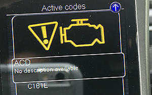

I'm pretty sure my ACD pump is failing. I'm getting "4WD System Service Required". Read engine codes are ACD and C161E. I pay $100 a month to garage my car in the winter and rarely drive. 3228 miles damn....

spam2012, have you checked your fluid level?
Old May 15, 2017 | 10:27 AM
spam2012's Avatar
Joined: May 2012
Posts: 42
From: Ohio
good idea about checking fluid levels but at 3200 miles and it being garaged for almost a year. I see no signs of liquid loss on my garage floor. I will try to take some pic under
Old May 15, 2017 | 10:58 AM
migs647's Avatar
Posts: 5,043
Likes: 62
From: Portland
Possible it was low from the factory too. They don't have the best history when it comes to filling fluids. In 2010 a lot of Evo Xs blew their transfer cases because the factory overfilled them.
