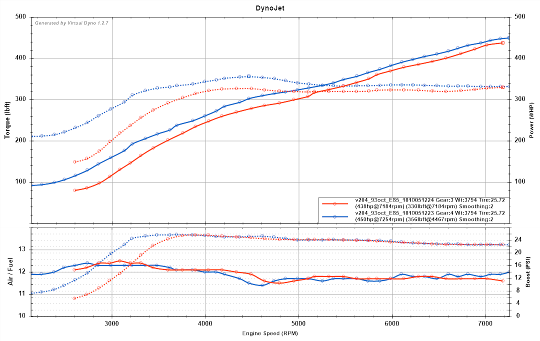

It's a 20G with a 9 blade TD05 turbine. That's not the point though. The point is that E85 requires 30% more fuel consumption than gasoline. So as soon as you start making some serious numbers the ID1050 are dangerously near becoming "static" (stuck open).
Here is my dyno graph, but what matters is I started around 220hp to the wheels:

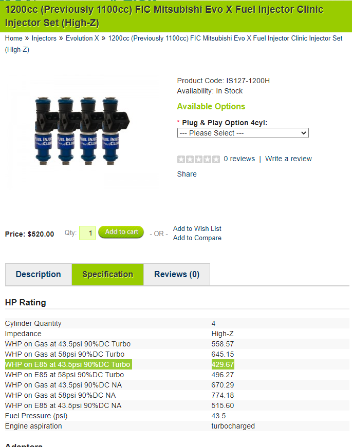

FIC 1200's will be close to maxed on an 18k with E85, if not maxed if you push it to the ~475whp reason. They really arent as big as advertised, they're a only a smidge bigger than the 1100's they replaced, which also didn't flow as advertised. FIC rates them at 429whp for E85/turbo at 43.5psi base pressure.
I would stick with ID1300's. Or FIC's new 1440 Hi-Z.
ahhh....Ok, good to know. Thanks
I stand corrected, apparently I am running these at the edge now and then:
