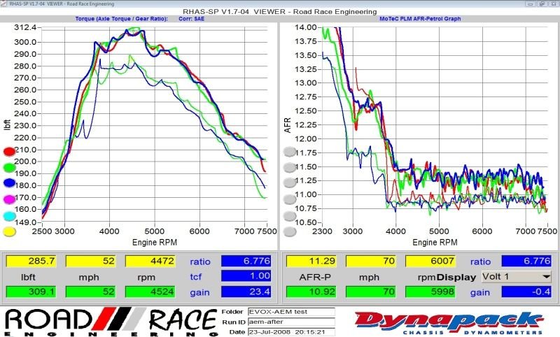

Yea, it's a great option for stock turbo in California. In fact, it's literally what I used when I was still stock turbo and lived in California.
I gained a healthy amount once adding the AEM intake and tuning for it.
Attached Thumbnails Evo X AEM box intake-oem_airbox_vs_aem_tunetweak2_e85_112413.png

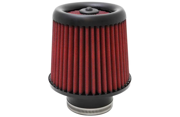

I personally like the AEM dry flow filter, because it doesn't use any oil that can potentially clog the MAF sensor. Of course, I'm aware that AEM has sold the filter line of business to K&N in 2009, but the dry flow is still a distinct line.

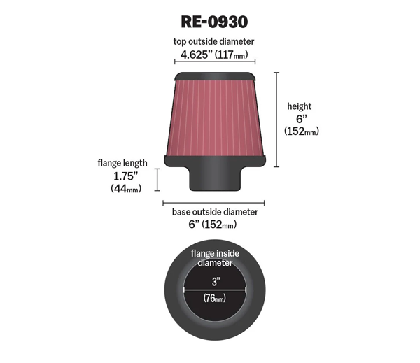

Recently when browsing AEM catalogs, I noticed that AEM makes the really big 3" FID dry flow filters for our cars as well. This means we can probably use the AMS performance intake (SRI), ditch the oiled filter (p/n: RE-0930) that comes with it, and clamp on an AEM dry flow filter. This way we can have the best of both worlds: the AMS SRI's large intake diameter without the turbo-choking airbox, and a properly sized dry flow filter that doesn't clog the MAP sensor.
The oiled filter RE-0930 has a flange inside diameter (FID) of 3", base outside diameter (BOD) of 6", and height (H) of 6". The AEM's "'really big 3" FID'" filter I found is 21-203D-XK (FID=3", BOD=6", H=5.563"), which will likely fit and it's big enough for our Evo X. With a pre-filter wrap, the cleaning and replacement interval will be comfortably long. If I end up with this setup myself in the future, I should post on the forum whether it works well.
K&N RE-0930: FID=3", BOD=6", H=6"
AEM 21-203D-XK: FID=3", BOD=6", H=5.563"
