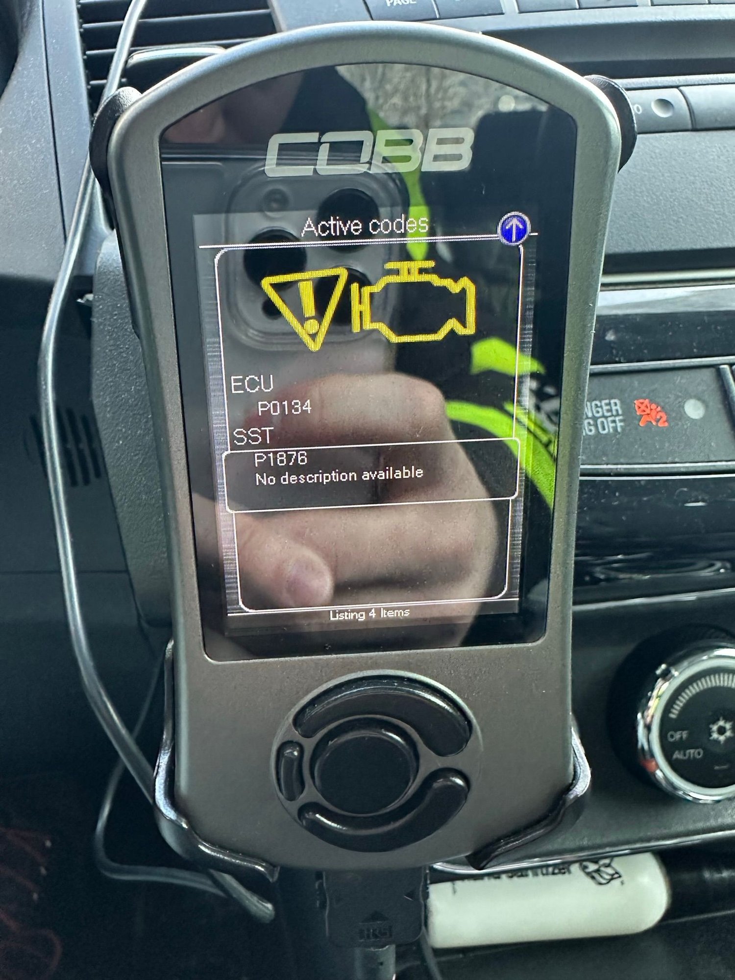

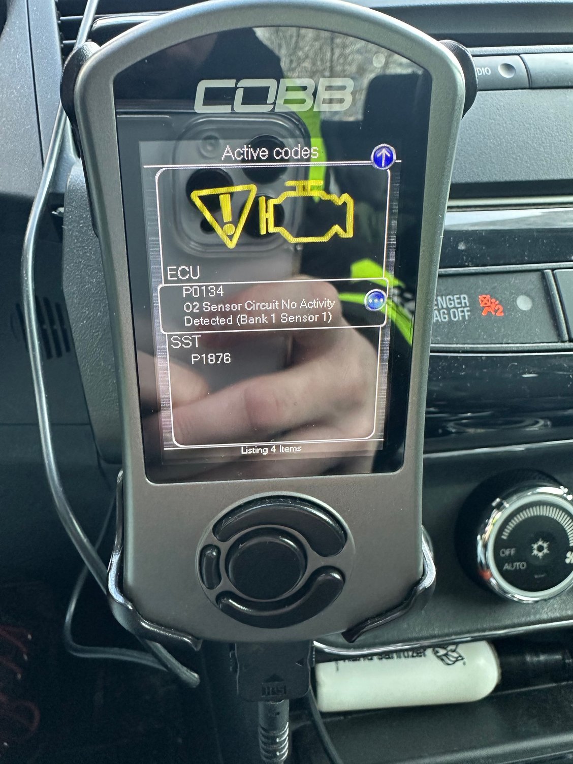

So my SST has been clunking into first when coming to stops. Not very horribly but noticeable enough for someone to look if I stop near them. This is in normal mode. The other day in S Sport in traffic I tried downshifting into first and it refused with the audible beep. I got to where I needed to go with no issue after that. Car Sat for 3 days and when I turned it on to idle for 10 mins I popped a ECU code P0134 and SST code P1876. I reset the ECU learning and drive 3 hrs home no issues besides the clunking I’ve been having. I notice that if I downshift more aggressively there’s no clunking sound but if I let the car coast to stop in like 4th gear then downshift to first quickly when almost stopped it does it. S Sport sometimes clunks into 2nd when downshifting. Any ideas? Take it in maybe or could be normal sounds? Now that the codes haven’t come back idk if there a reason to take it in. I’m over 100K mi

P1876 is first gear lock-out. Which could be a few reasons. Your 1/R plunger is failing. The mechatronic is clogged or broken or some other aspect of it is failing. Magnet could be out of alignment (tho 1 forks rarely fail historically). But it's not looking good in general with that code.
