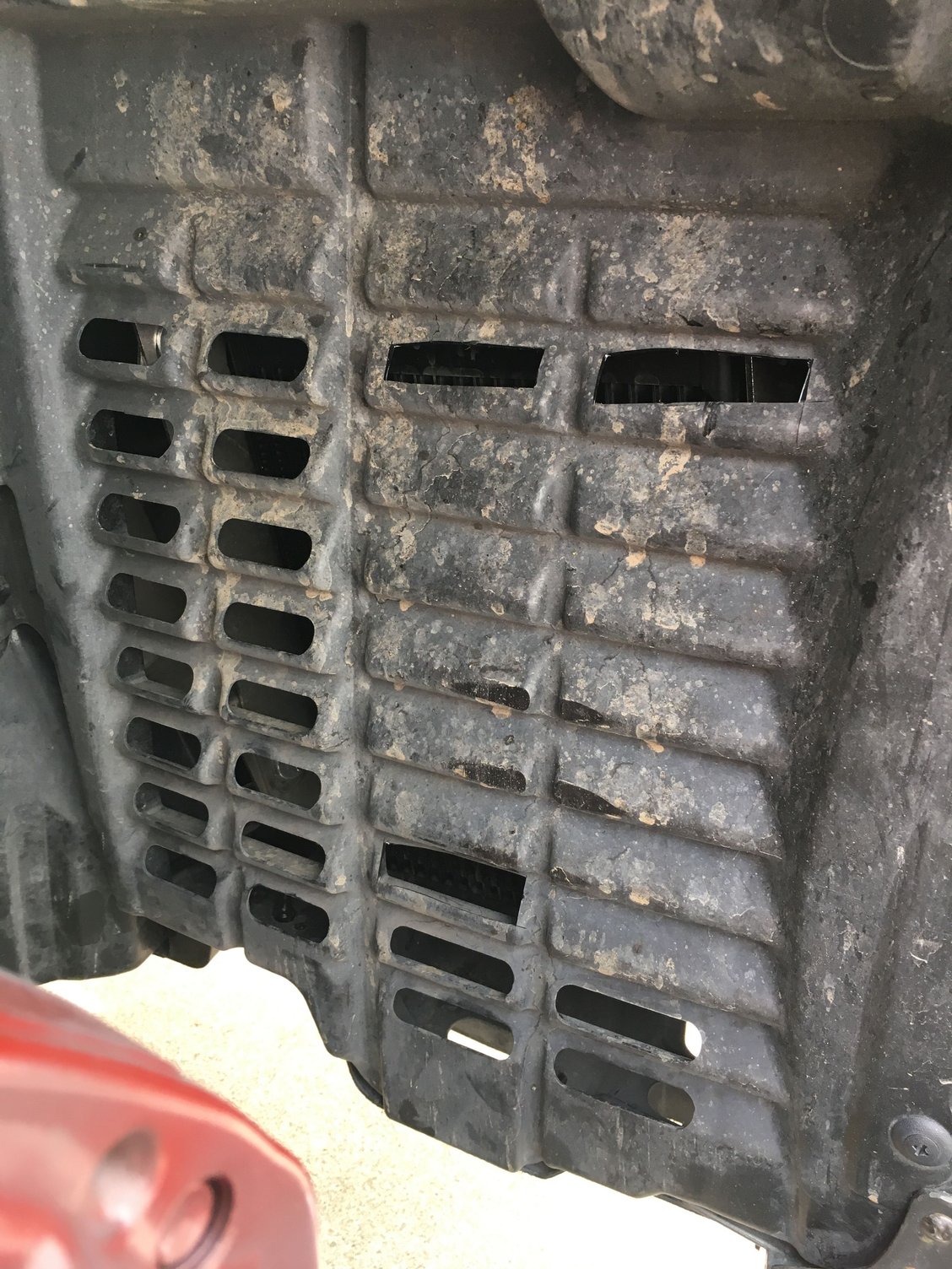

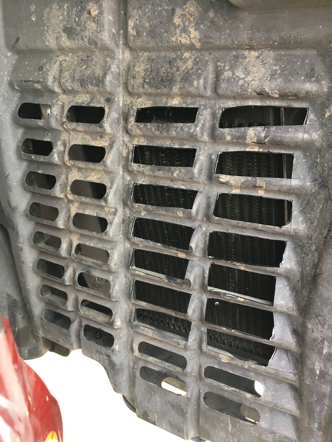

The fan will block airflow at speed. I recommend against it. You also have little to no room behind the oil cooler to add a fan. Especially if you are running higher offset wheels with 275+ tires.
Just cut out the factor fender liner vents more, that will give the cooler more airflow. The oem liner only has one side with holes. Here is before and after of mine:

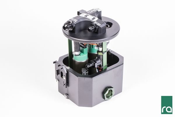

I'm not sure when Radium changed the fuel hanger design but if it was before the 21st of October 2020 their new design will still need a surge tank.
Does your fuel basket look like the first or second one:

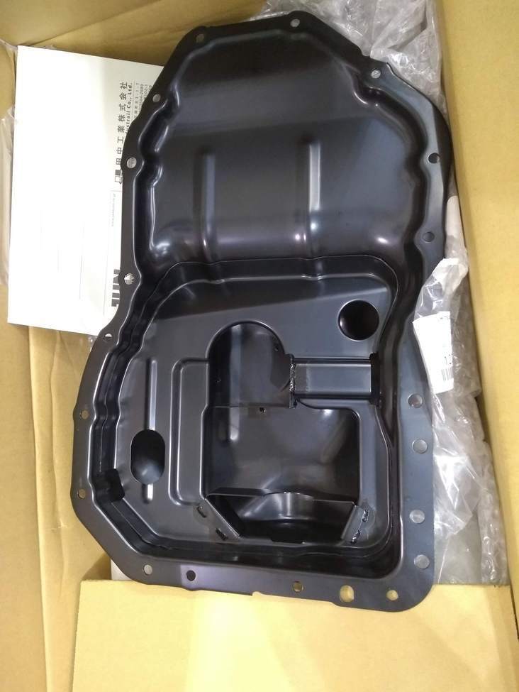

Did you happen to take any pictures of your JUN oil pan before you installed it?
Here is a video show the JUN next to the Moroso. Keep in mind his comments are before trying to install the Moroso pan. In fact, later he puts in the comments that it was a nightmare trying to fit it.

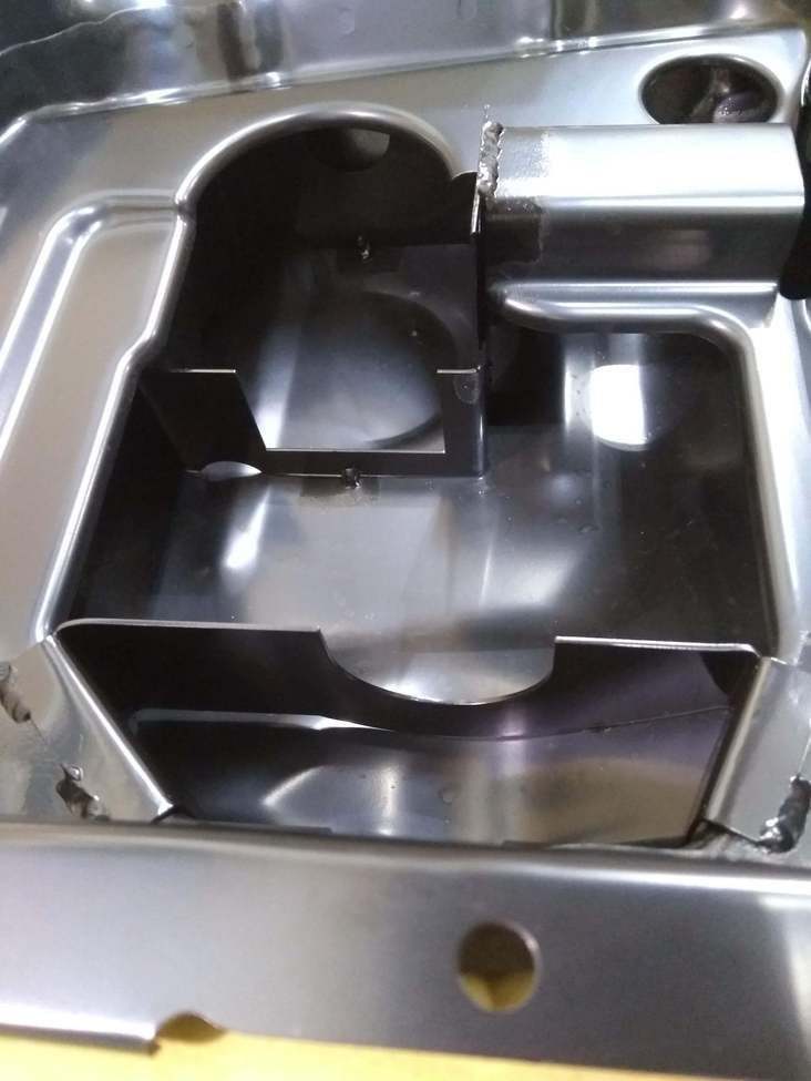

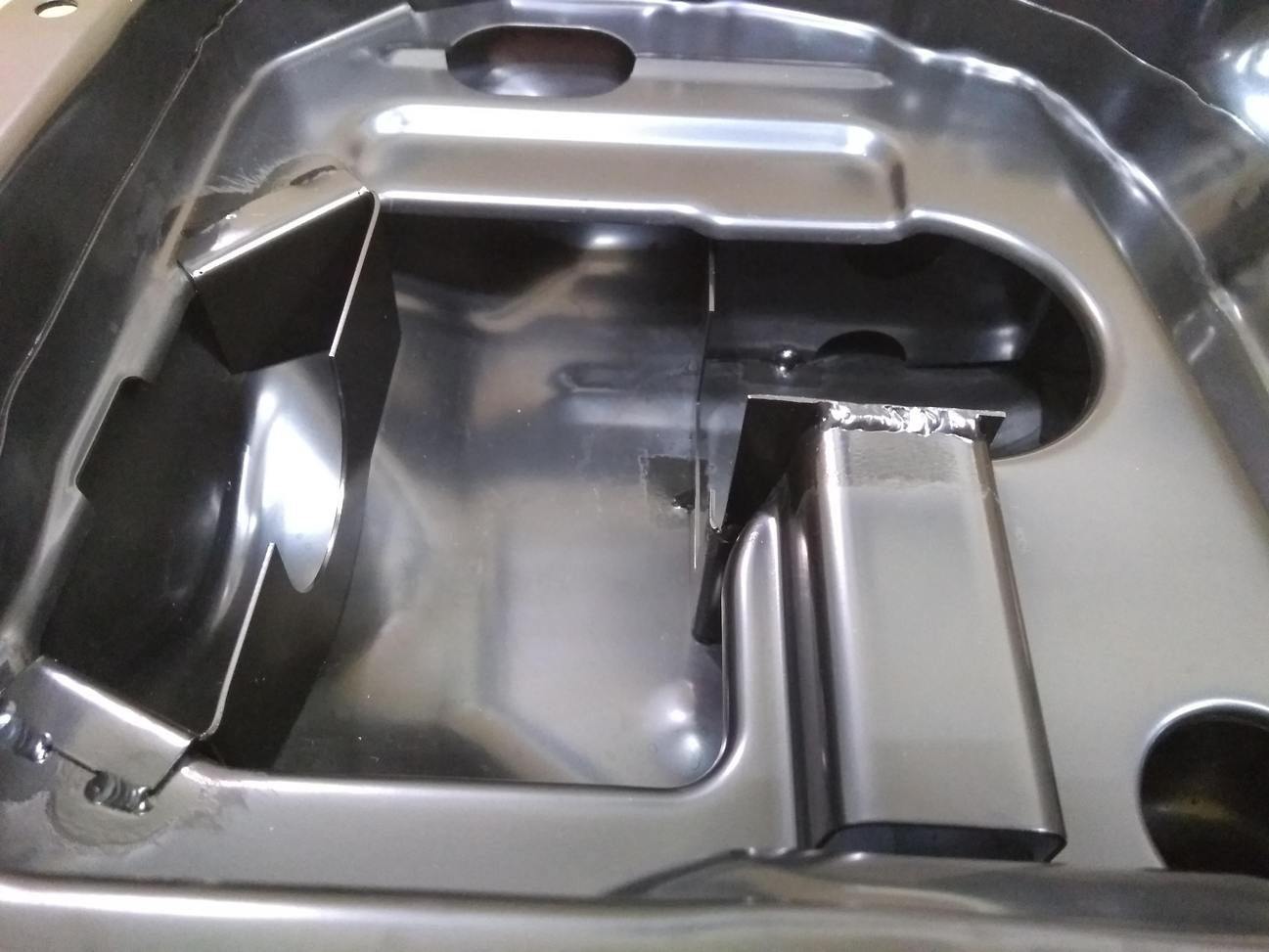

Yes I did:

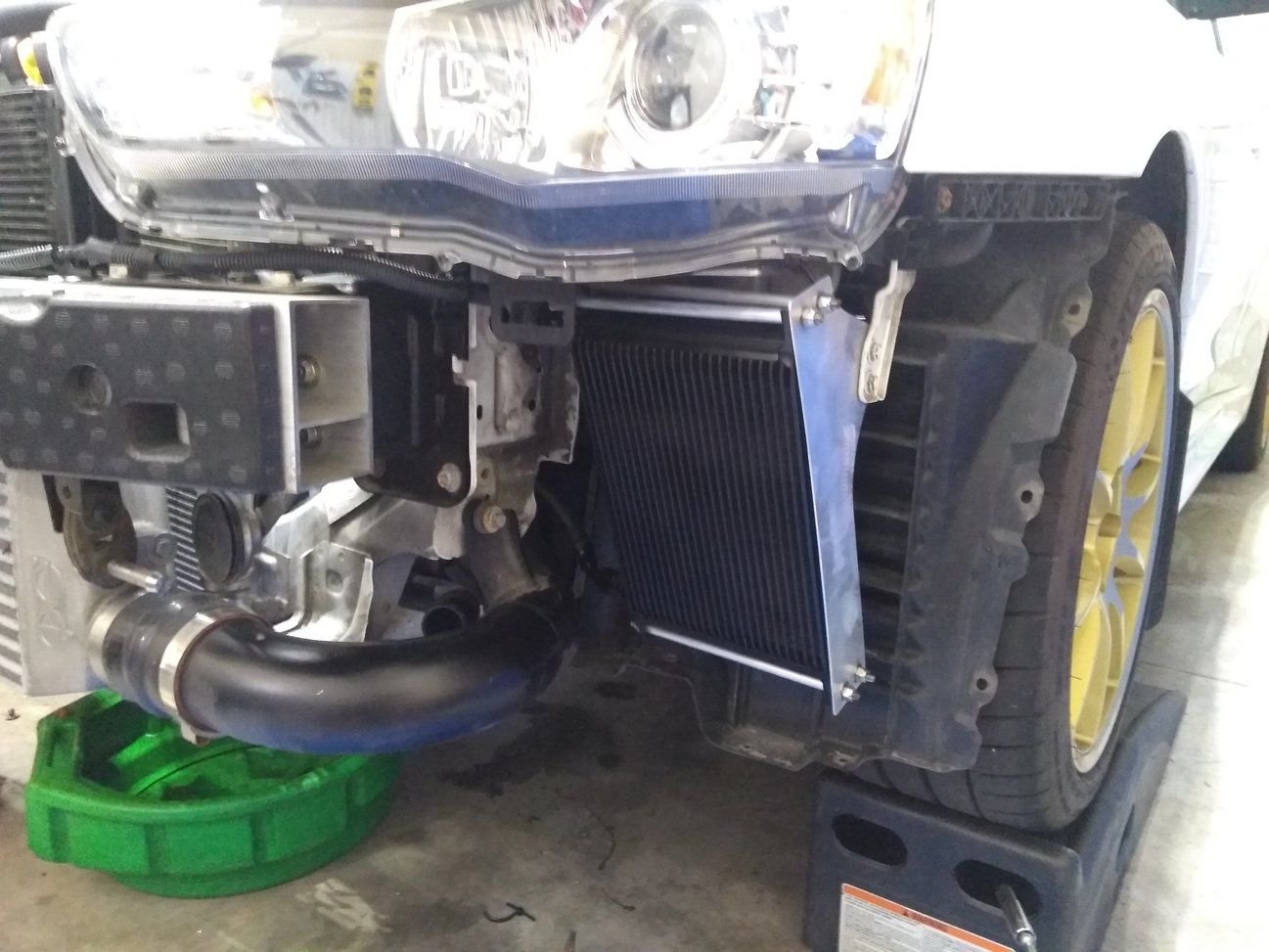

Here is the 25 dual Derale setup I have going on:
Drivers side for SST (one of three coolers):
25 Row for OIL:

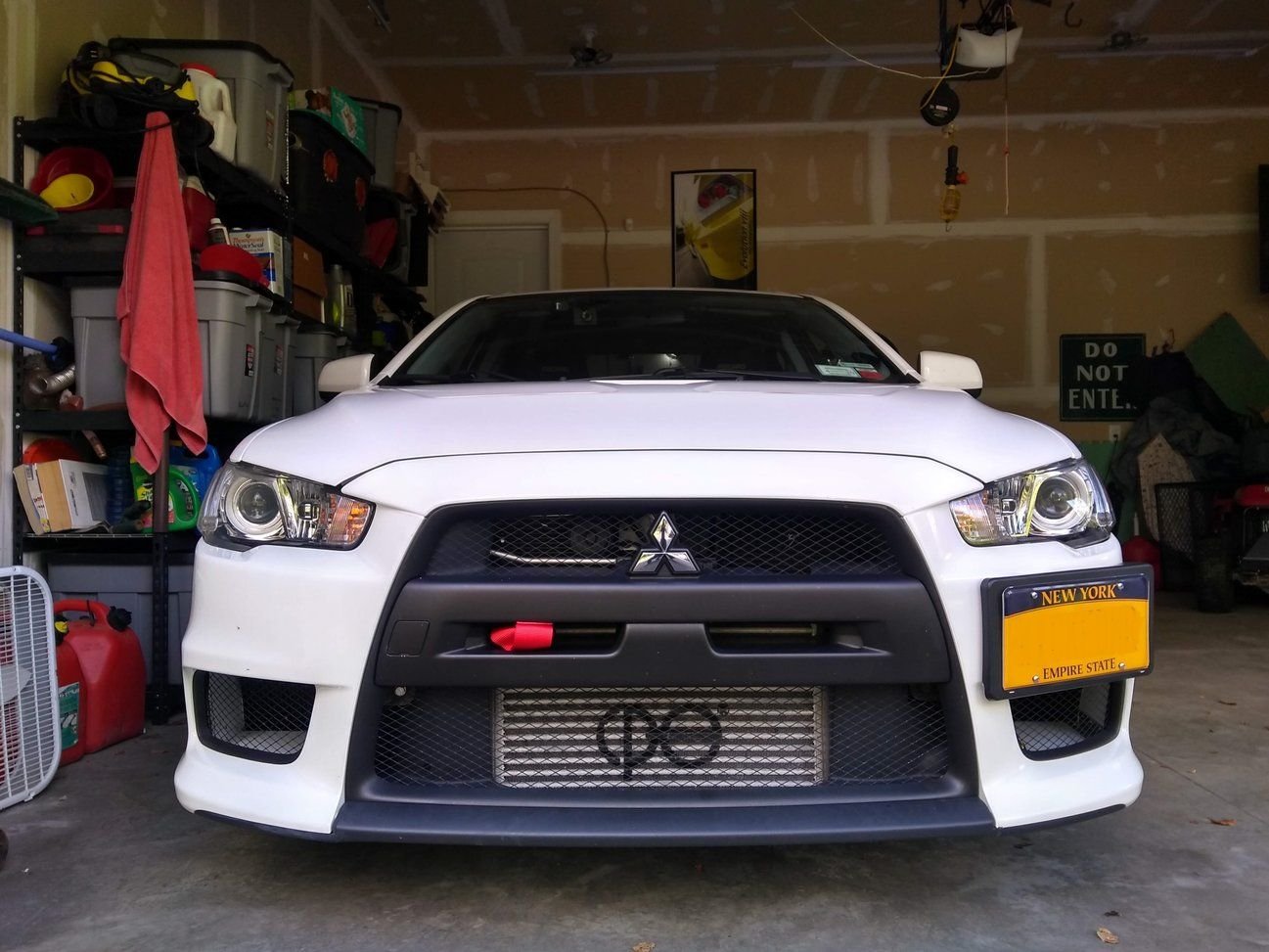

Final front end with ductwork and coolers:

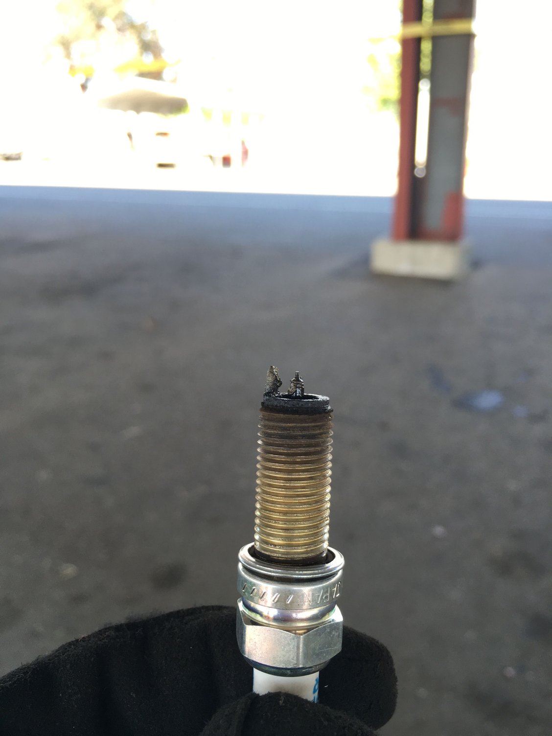

Originally Posted by kyoo

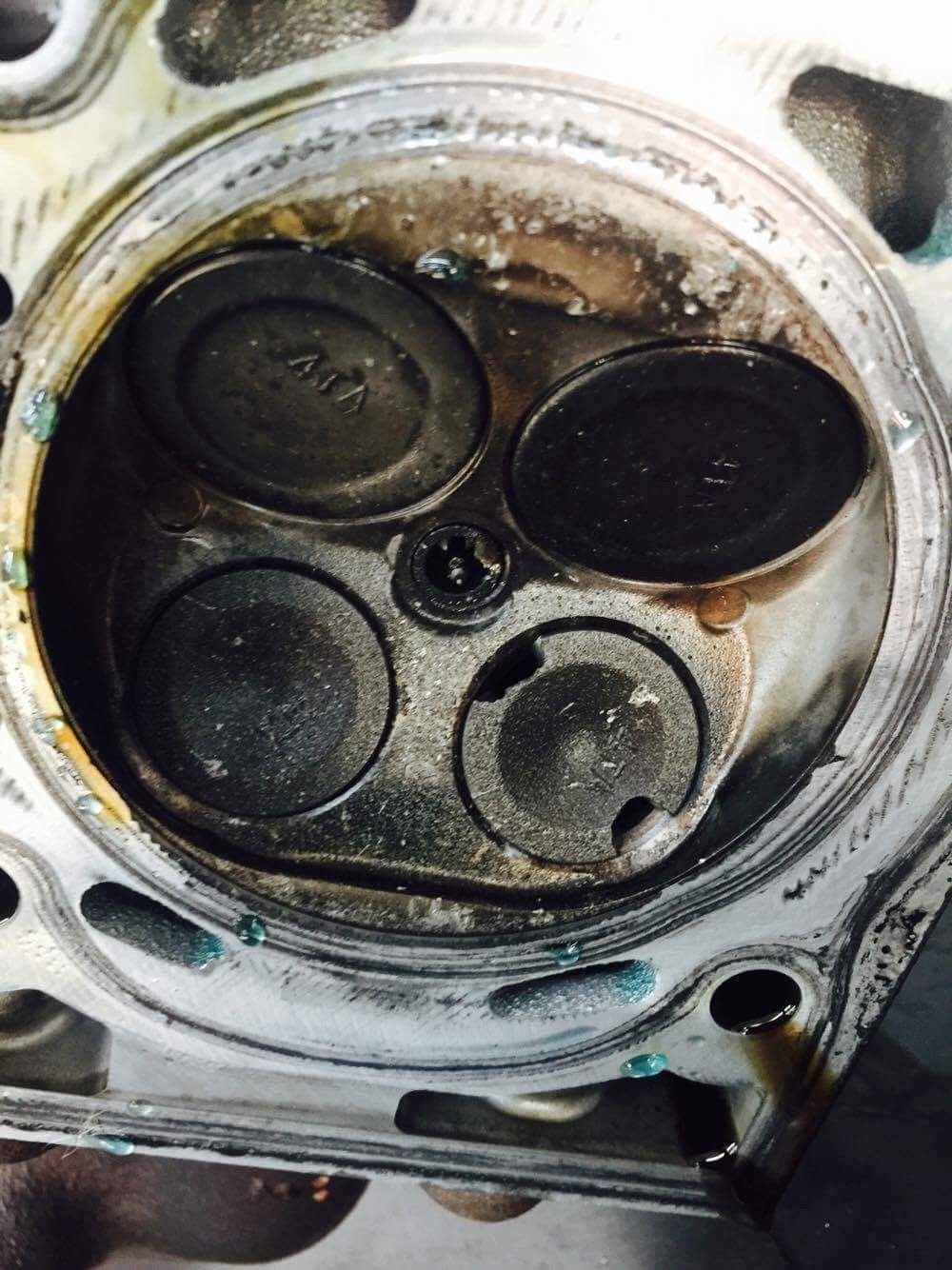

i mean regardless of starve per se, any car will reach a point where there's no more fuel picked up (the top gear bit ran them until totally empty) - what then? mass lean to detonation?
Mass lean and things like this happen, this is my spark plug and valve when my Evo 10 was starved of fuel.

I guess the short answer is that running out while idling versus running out under high load determines if damage will occur. It isn't good for ANY car to run out (and hence go lean) under load. The pics razorlab posted are a great example of the mayhem that occurs!
