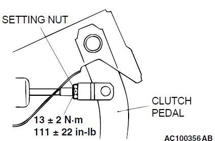

Which way to adjust to lower the pedal engagement. Just replaced my cmc and the pedal is a little high for my liking.. is it clockwise to go lower?

If you are asking about which way to turn the CMC push rod after loosening the setting nut behind the clevis pin, then it is anti-clockwise as you look at it, which will lower the pedal and so the engagement point.
